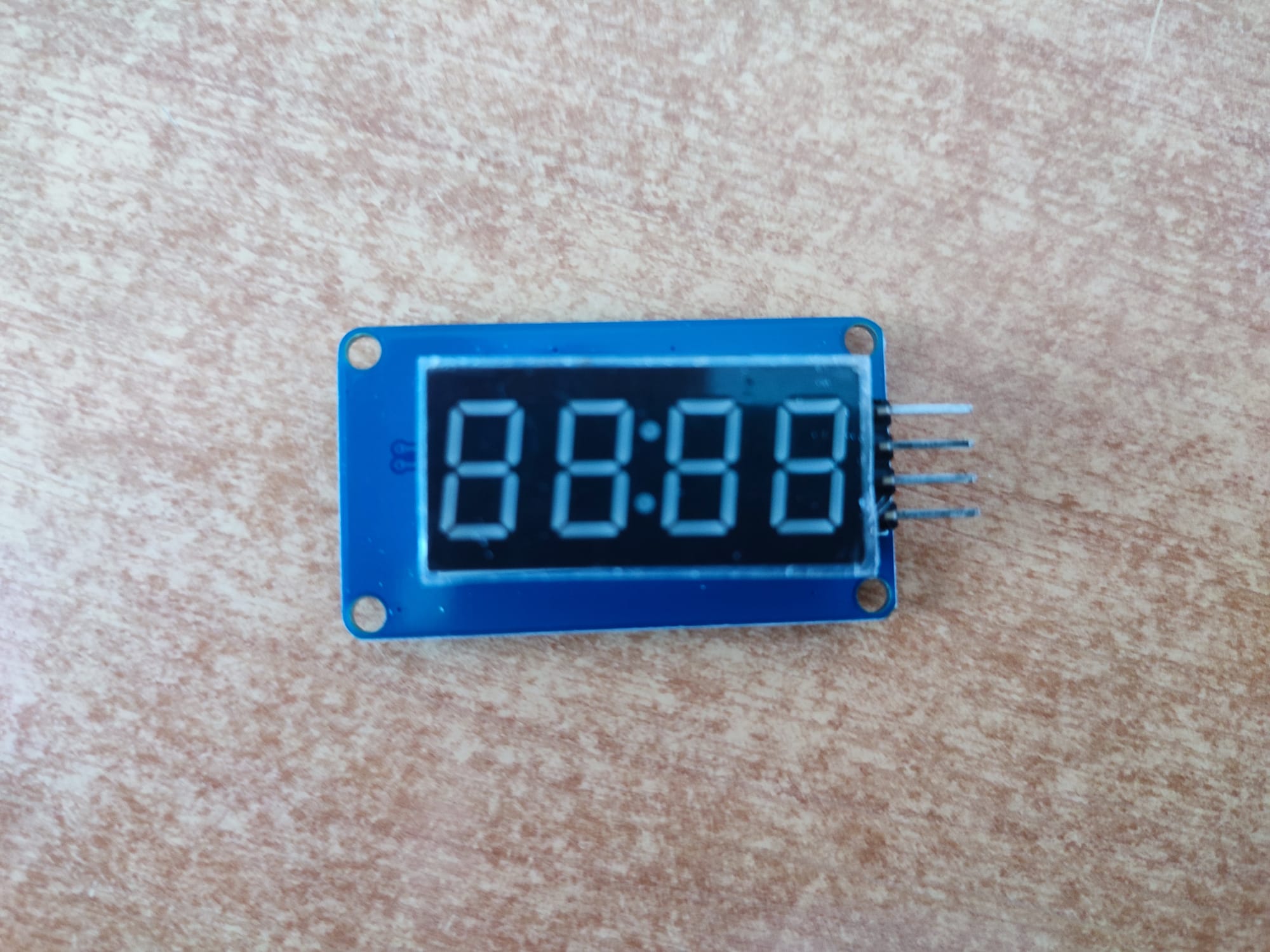

How could I connect a 4 pin clock to arduino?
I have the one attached in the photos:
I would like to display the temperature and humidity values measured by a dht22 sensor, like 22(temp value) : 54 (humidity value)

Yes it is possible, maybe start here for example of how to connect the display and getting it showing some numbers.

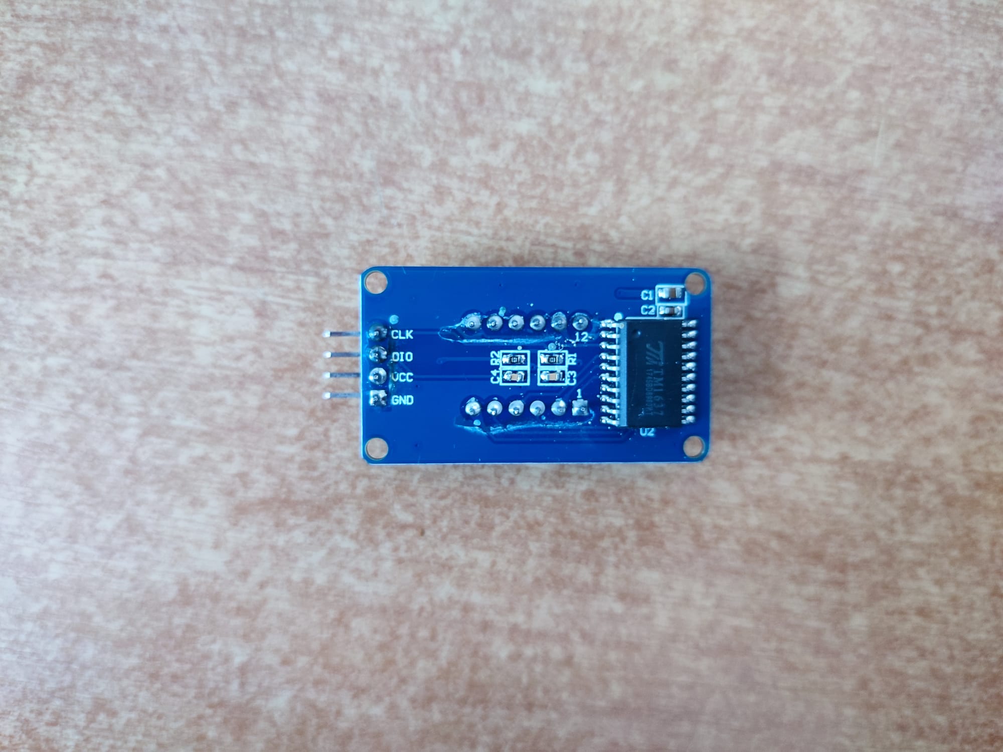

I found the datasheet for you:
(Note: It's in Chinese)
It looks like the TM1617 chip on this board has been superseded by the TM1637 chip. Perhaps libraries for the newer chip will work on the old chip.
