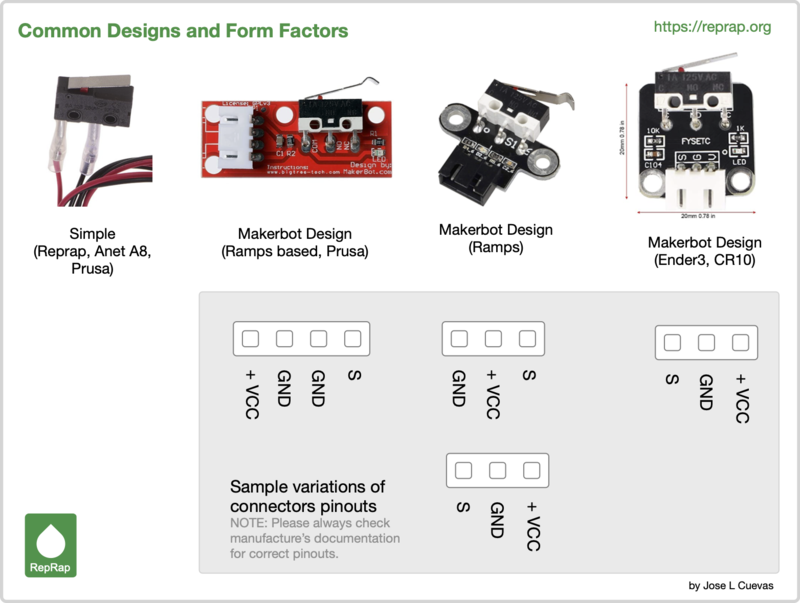

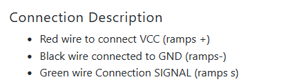

As my red Endstop has 3 wires:
Red: +5V to Normally Closed contact and LED
Black: Ground to Normally Open contact.
Green: Signal from Common contact and +5V pull-up.
Should i connect them:
Black to GND
Green to 3V
Red to D4

You need only the NO or the NC, but not both.
Read the datasheet how to connect.
p.s.
Post a link.
Post a link of the Endstop switch.
