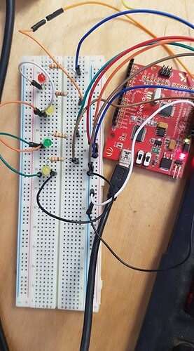

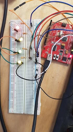

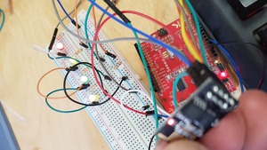

OK, to make troubleshooting easier, i went back to a simpler version of the code and switched the relay with a simple LED. I also tested the GPIO 2 pin of the ESP-01 instead of engaging in more advanced RX/TX to GPIO conversions.
Here is the code:

Thanks for this helpful information. I don't know much about that type of relay but i will investigate about it. For now, i'm just using LEDs instead of relays to make it easier to prototype and understand how to work with the ESP-01's 4 GPIO pins (including RX and TX pins). I connected each of the 4 GPIO pins to a different LED via its own 330 Ohms resistor. But is it better to use 470 Ohms instead?
The program was not running with the 4 GPIOs already connected at boot up. So, i tried disconnecting each GPIO and reset the ESP-01 to see which one was blocking the boot-up and normal program running mode. I found that the program ran normally by disconnecting the GPIO 2 cable from its LED, rebooted the ESP-01, waited a few seconds and now the other 3 GPIOs work. What is this special mode called when GPIO 2 is connected to an LED? I know that GPIO 0 when grounded sets the ESP-01 in programming mode, so is this another programming mode?
From my testing, GPIO 0 can be left connected to an LED and the boot-up proceeds normally. Did i miss anything?
This is my setup. Sorry, the ESP-01 is out of frame.

I followed your instructions and i connected GPIO 0 and 2 to 10kOhms pull-up resistors and now it works! :slight_smile:
