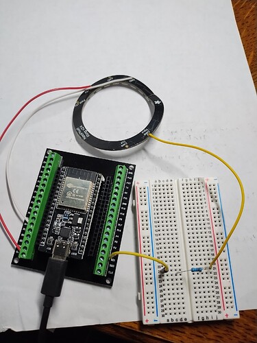

I connected :
ESP32 GND to RING GND
ESP32 +5v to RING +5v
ESP32 gpio 15 to 350 ohm resistor to Ring Data input
The ESP32 is running the code listed above , when should turn on the first 3 LED, but nothing happens.
Here is a a picture of my wires
The ESP32, in fact all ESP processors run at 3V3 so that means you are trying to power a 5V LED with only 3V3 signals.
You need some sort of level shifter to boost the 3V3 signal to 5V. The level shifters designed for I2C are not fast enough to take the required speed and work on the limit. I use an external logic chip to power all my 3V3 systems. this is the circuit I use :-
The dotted box represents the chip, a hex (6 of ) inverter gates, bit you only need to use two.
Although there are other chips you can use.
Be aware you need an external 5V supply in order to supply enough current to the LEDs, you can not dothis from the simple USB input.

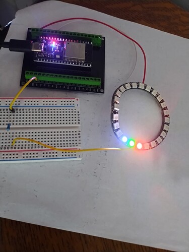

Grumpy Mike, I didn't change anything , and it started working! I am just using the resistor connected to gpio pin . The "level shifter" helps if big power draw , like more LED lights right?
No.
Once the first led is lit then the signal is regenerated as a 5V signal by the next led. You must be on the edge of it working, so might not be reliable.
You also need a capacitor something like 100 to 1000uF at the start of each LED ring to smooth the voltage, this is especially true with a long chain of LEDs.
It is likely it didn't work before because you solderless bread board was not making good connections, they are notorious for that.
Also remember that an un lit LED takes about 1mA of current so with long chains this can be significant.
