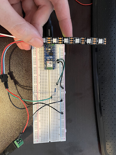

LED-strip can draw several amps of current, depending on number of LEDs. It's not ok to use breadboard to power it.
Wire your black and red directly to power supply screw connector, with one additional black for common GND.
Since it's such a short distance and only 6 LEDs why wouldn't 3.3 V work? Feels like the esp32 isn't sending any data.
Same issue when wired directly. Could this be an issue with the esp32?
So direct 4.5V supply, common ground, 6 LEDs?

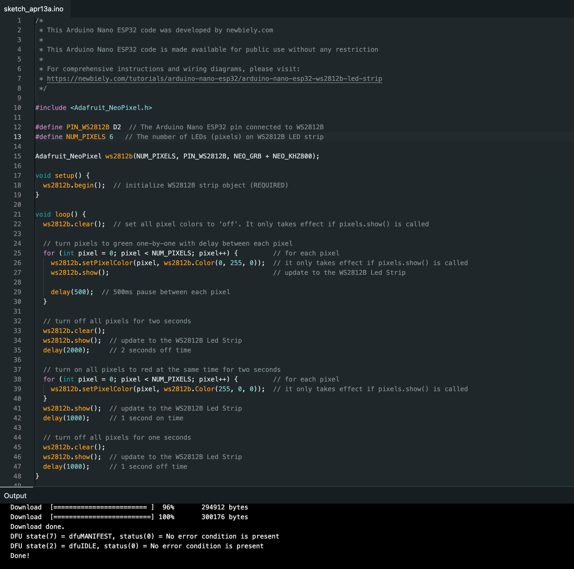

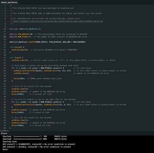

If you don't get anything out, time to post your code (using code tags).
Here is the latest config with the code.
  NeoPixel.begin();  // initialize NeoPixel strip object (REQUIRED)
  NeoPixel.clear();  // set all pixel colors to 'off'. It only takes effect if pixels.show() is called
  // turn pixels to green one-by-one with delay between each pixel
  for (int pixel = 0; pixel < NUM_PIXELS; pixel++) {           // for each pixel
    NeoPixel.setPixelColor(pixel, NeoPixel.Color(0, 255, 0));  // it only takes effect if pixels.show() is called
    NeoPixel.show();                                           // update to the NeoPixel Led Strip
    delay(500);  // 500ms pause between each pixel
  // turn off all pixels for two seconds
  NeoPixel.clear();
  delay(2000);      // 2 seconds off time
  // turn on all pixels to red at the same time for two seconds
    NeoPixel.setPixelColor(pixel, NeoPixel.Color(255, 0, 0));  // it only takes effect if pixels.show() is called
  delay(1000);      // 1 second on time
  // turn off all pixels for one seconds
  NeoPixel.clear();
  delay(1000);      // 1 second off time
