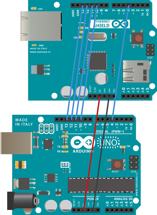

How to connect arduino mega 2560 by W5100 ethernet shild with jumpers?
Which pin on the mega associated with pin on the W5100 with a jumper?
Thank you
Depends a little on if its a REAL one or a clone or the variation but all you had to do was google
Select the one you are using and thats it.
But here is the standard method.
NOTE...The pass through for the ICSP would need to be connected to the MEGA and NOT the ethernet shield.
