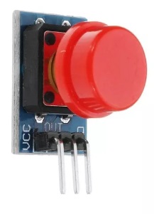

I want to control a fan with a switch. When I press the button (switch on the diagram), the fan starts spinning, when I release, the fan stops.
However, no matter what I try, the fan starts and stops at random time. It seems that the potential at the transistor base is floating. What's very frustrating is that initially, the fan perfectly responds to pressing the button, but after a few minutes it starts spinning randomly.
Do you know what's going on?

Your circuit is wrong. First the transistor need to be a PNP type but it and the regulator are not necessary if you want to control the TIP121
can I do that without damaging the switch?

Thank you, I will try. No need for a 7805 either, I guess.
No you don't.
Make sure NOT to connect the Vcc pin on the button module to ANYTHING. It will have 12V on it, so it would be a good idea to put a piece of tape on it so it does not accidentally touch anything
Hi Jim-p, thank you, it works.
