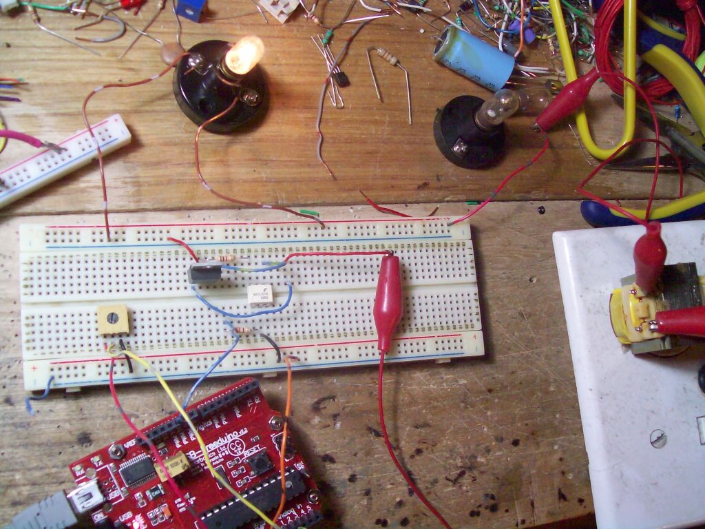

I will do an experiment this week-end using a opto and triac. I will use a 12 V AC source to control a light bulb and see what happen <--- that could be breadboard. And I will construct a test rig for the AC main test.

I did the experiment. I use a 12 V AC in with a 12 V light bulb. I included picture of my setup and a schematic. No 120 V AC test yet. I need to change the value of R2 to control the curent going into the Triac gate. My setup is about 6 mA to the gate using 1 K.
The limiting resistor of 330 is the LED side of the optocoupler.
First, I did the "blink" test. Pass and it is flashing. But I did the PWM test, and I did not see a difference at all. Because, when the light bulb is on and going off, a next pulse will turn on and so fourth. A led can switch on / off fast, but not a light bulb, it is just too slow to responce an PWM signal. So to my eyes, it seem ON. A slow pulse will blink it.
So, the light bulb need to see a voltage reduction for a dimming effect to work. Therefore, a different circuit is needed for a dimming to work.

Even with PWM values down to like 1??
I find this very surprising.
Using a similar but 6v version of the same bulb on DC, it dims just fine with PWM.
If the duty cycle is significantly reduced, I find it hard to believe that the filament will reach and maintain full temperature.
I would guess maybe the triac is not behaving how you expect it to. Do you have a scope to test it with?

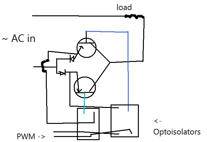

I wonder if it is possible to have a PNP and a NPN transistor in parallel E <-> E and C <-> C each with a diode facing the opposet direction in series with it
And using two opto-isolators, driving the base with the polarity of the other line.
I have posted a schematic for a device that may theoretically work but it is completely untested.
Resistors omitted for simplicity but obviously necessary. This should allow for instantaneous switching almost irregardless of the AC wave phase.
oops, forgot to attach.

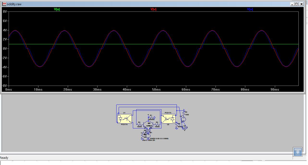

I actually tested it on LTSpice circuit simulator and it seems to work great.
I just do not have two opto-isolators to test it.
Basically it applies the base current through the opto-isolators. This resolves the polarity difference of the base current.

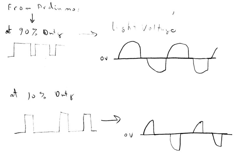

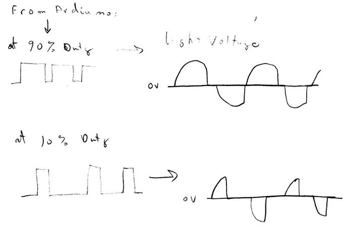

A dimmer work by reducing the voltage at the load. It "cut" the AC sine wave, to created a lower voltage effect.
So you need a circuit at the AC side to convert the PWM pulse into a partial cut AC sine wave.

A light bulb is mostly a resistive device so that all that matters is average power.
It does not care much what the sine wave looks like. If you make "chops" out of the AC wave with a PWM signal, then the bulb will heat less proportionally. If you tried the same test circuit with a mosfet instead of a triac and DC instead of AC, I am willing to bet that it would dim exactly as you would want it to. The reason your test circuit did not work is because the triac does not stop conduction instantaneously.

The reaction time does not matter if the average power is reduced.
I certainly do not suggest testing it with full AC line voltage. Testing it will full AC line voltage should only be done if the small scale is working good. Using the circuit I posted should work to PWM the AC wave instead of a triac. Unfortunately I do not have the parts to test it. The LTSpice simulation works good though.
I know that electronics simulations are hit and miss but I have attached the waveforms.
The first shows the input, output, and about 40% PWM duty signal. As you can see, the average power is reduced.
The second shows it with a constant input signal passing the AC near as-is.
RED is 60hz 4v input
GREEN is the ~1.5v control signal
BLUE is the output

I attached another schematic. Its alittle better but still alittle unclear.
I do not have a BOM or parts list because the resistors, transistors and opto-isolators all depend on how much voltage and current you run through it.
I hope the sim did not use the same ground.
It did but thats to satisfy a silly simulator requirement.
I will tested it with a 12 V AC and use the Arduino for the PWM and see what happen.
Good luck and be-careful. Using AC around an Arduino even at low voltage can be a disaster if you are not careful.
Note: I may have drawn the opto-isolators backwards.
Note2: R1, R4 are relatively high value and R2 and R3 were relatively low value.
