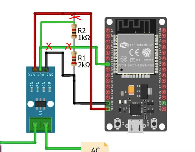

I am trying to use an ACS712 with an ESP32, I am however struggling to calibrate it to zero at zero/short circuit current. Even when I get the value close to zero, just unplugging the usb and plugging it shifts the value to +0.5A or sometimes more.
Here are the values I am getting:
I am using the 20A version , the esp32 is powered therough the USB of a pc and the ACS712 I am powering from the 5v pin of the ESP32. I tried and added decoupling caps on the power pins of the sensor and on the power of the ESP32 and still no success.

The ESP32 pins are limited to 3.3V.
Do you have a voltage divider between the ACS712 and the ESP?
Does you ESP board have a voltage divider on it?

You never will get an ACS712 to play nicely with an ESP. An ACS712 has a ratiometric output that needs a ratiometric A/D, which the ESP doesn't have (An Uno R3 does). With an ESP, current and zero point also depend on supply voltage of the ACS. If you want to get it sort-off ok, then you also need to measure ACS supply voltage, and add that variation to the current equation.
Leo..
I have tried almost everything listed here and elsewhere, Wawa is right you can't get it to play nicely, just plugging/unplugging the USB cable will cause the zero current value to drift substantially. I finally used a Zero function, so whenever I need to measure current it first consider whatever value coming from the sensor to be zero. Then the results are good enough.
You are right!
Incidentally, look at the divider diagram in post 3, the resistor R2 should not be connected to VDD (+5V) but to the ACS output.

I tried several 30A sensors with esp32 and found out:
  • Use a Voltage divider like pin0010 said.
  • Connections are really important. Solder on the connections.
  • Each sensor has a different zero and sensitivity. Measure and calibrate for each sensor once. Use an average of multiple measurements to calculate the offset and sensitivity, I use 1000 measurements.
  • If the connections are good, there should be almost no difference in current measurements the next time you connect the same ACS712 to an ESP32.
  • It seems like starting up the ESP32 has some effect on the measurements values, at least in my case where I am using WiFi. So calculate the offset in the main loop, not in the setup.
