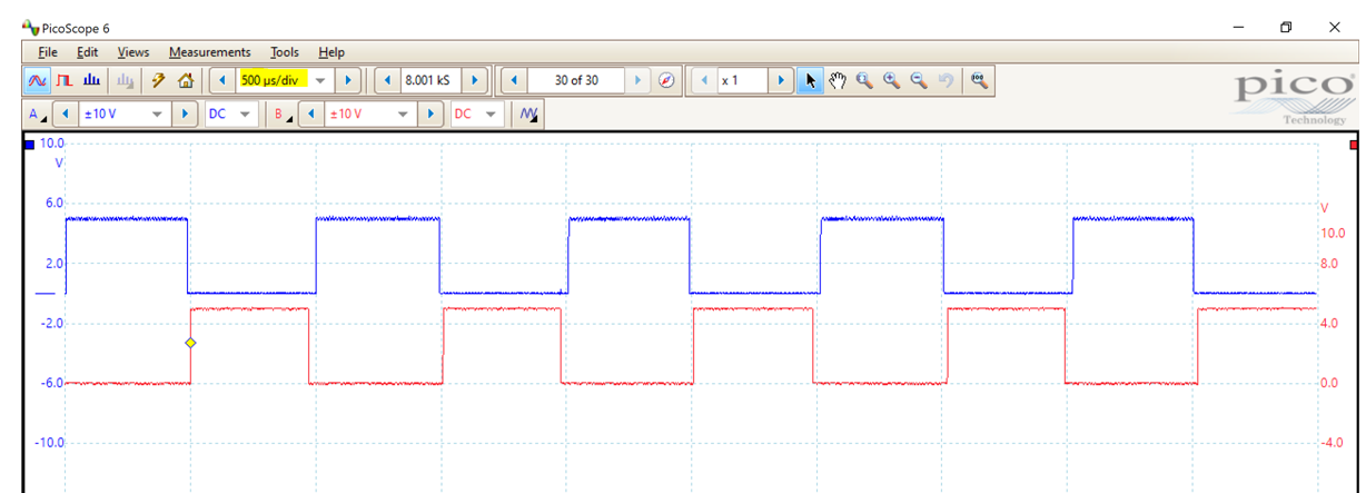

Perhaps something like this. At least there's proper data for it. It depends how loud you want it to be. You could perhaps drive it with two anti-phase gpio pins to double the output voltage from peak ~= Vcc to peak ~= 2xVcc. Around the resonant frequency the impedance is > 1000 ohms, so you wouldn't need current limiting resistors to limit the current or transistors to boost the current.
Anti-phase looks like this on an oscilloscope, this screen snip is for 1kHz, but the same idea would apply for 25kHz.

Do I create these anti-phase gpio pins with inverted PWM Signals or how can I get them?

In my application (a 1kHz beep for a geiger counter) I change the volume by changing the pulse width.
I'm doing this on an ATtiny85 running at 8MHz. I do it in C++ using digitalWrite() and delays using micros(). I don't have any experience of using PWM other than basic things like LED brightness control. I don't know about inverted PWM.
