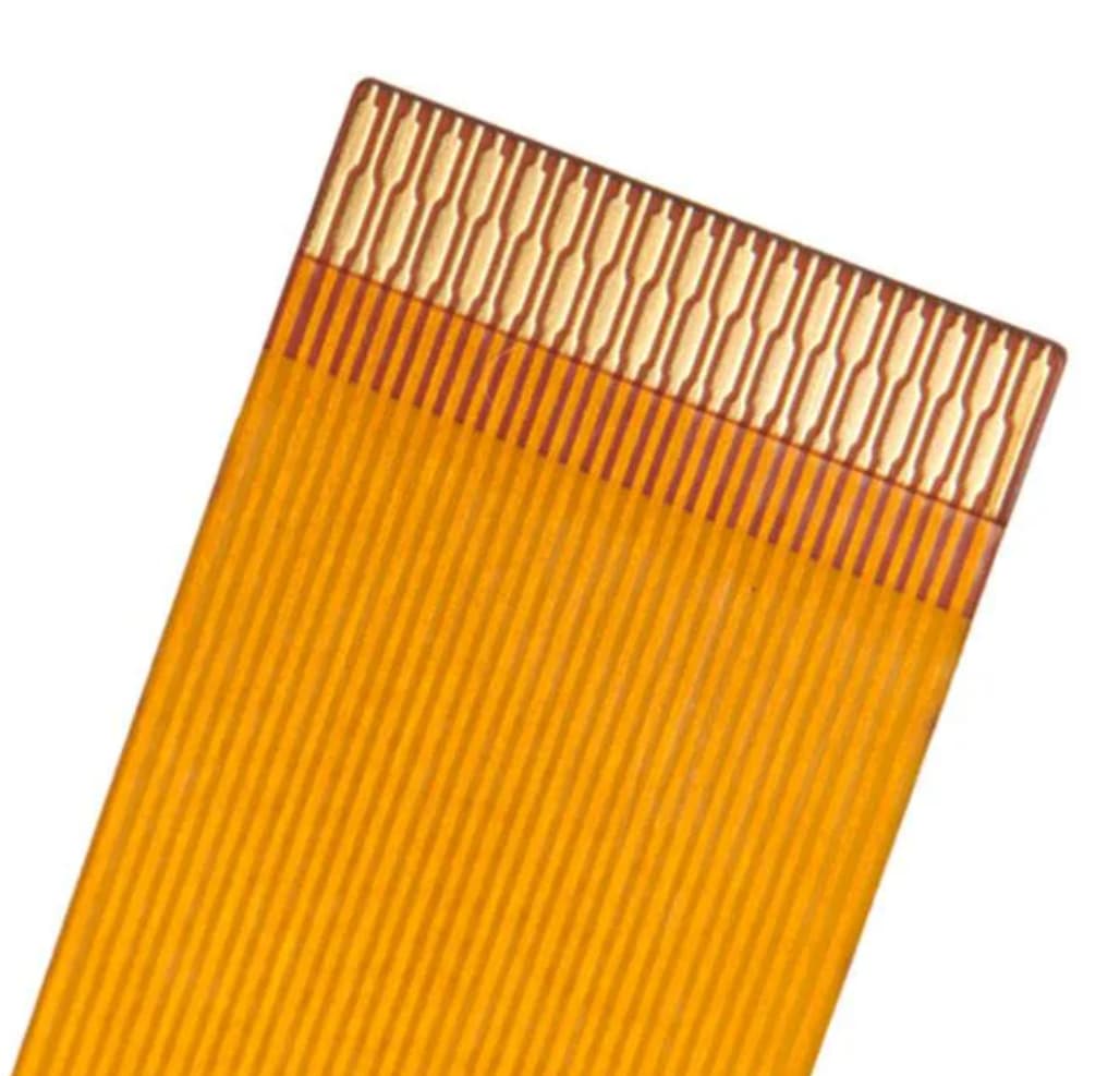

How to extend the LCD flexible cable, I found an LCD whose cable is 1cm short. Due to the difficulty of placing the design, I want to extend the cable

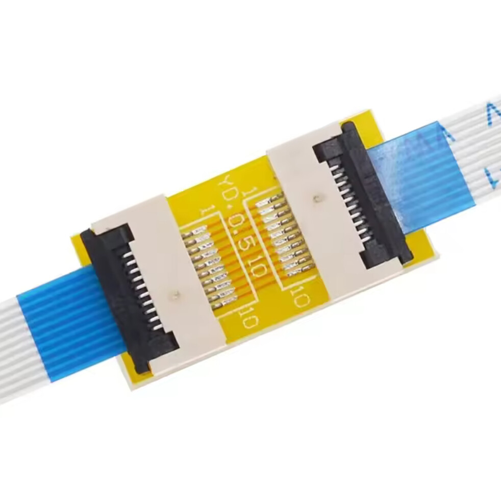

In my country, ribbon cable extenders are not widely sold.
If this is targeted for production contact the display manufacturer they will gladly make the cable longer if you are using what they consider a reasonable quantity.
This the reason they posted a link.
You only need to find one seller!

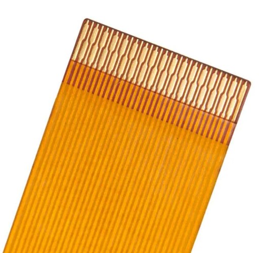

Can the cables be soldered considering the different types of ends?
FPC (Flexible Printed Circuit) or FFC (Flat Flexible Cable) are typically not designed to be soldered directly. They are usually connected via specific connectors designed to hold the flat ribbon securely to provide a reliable electrical connection.
I think you need to use a dedicated FFC/FLC connector or a breakout board designed for this purpose.
