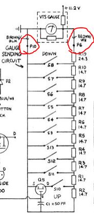

I attached a picture of the schematic of the circuit that is being used by the system. The two circled wires in red are what I am able to read off of.

That's different from how you described it.This way every single switch (including the limit switches UP and DOWN) has a unique resistance. You should be able to read the voltage on P6 with an analog input - likely you need an additional voltage divider to bring it down to a proper value, ideally to a value of 0-1V so you can read it with the internal reference.
Now the second problem is that this voltage is not going to be stable: it will vary with the battery voltage of the snow machine itself. So you will also have to read this voltage (on a separate analog input), or you may end up in between two switches with your calculated resistance reading...

So this circuit that I have above is not hooked up to any power. So I am not able to read any voltage. I can only read a resistance between the two wires.
Then you will need to apply a voltage.
The Arduino cannot measure resistance.
What is the value of the first resistor on the voltmeter or did you not intend to use this part?
The arrangement you show above is a variable shunt value however, the low value might well need a rethink for direct input to arduino.
How many steps do you need?
This is basically a variable resistor, with the value depending on which reed switch is closed (you should be able to read this resistance with your multimeter). If those numbers are the resistance in Ohm, that is a very low resistance giving pretty high current when connected straight to the 5V.
Then there's this mysterious Q5, a MOSFET that can block the UP signal entirely. The schematic suggests there's a third connection to this device, where this MOSFET is connected. Unless you switch this on the reed S10 is not going to do anything and you can not detect its signal.
I only have access to wires P10 and P6 as shown in the schematic I had posted. I connected a multimeter between these two wires and slide the shaft along the reed switches. The Ohm values I read are below when moving the shaft from up to down.
168.7 ohm

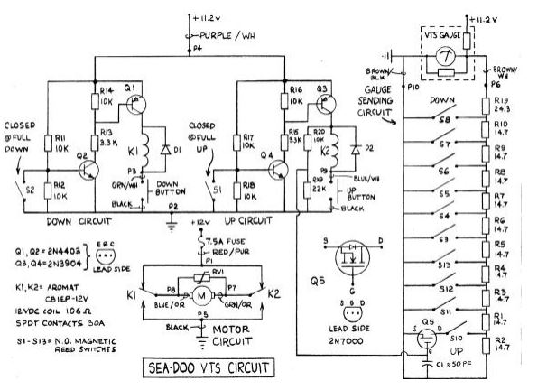

The 168.7 ohm is the limits of travel. Below is the whole schematic if you wanted to see. This is how the systems is supposed to work. However, it was destroyed with water and doesn't work with power hooked to it. Just shorts out.

Looking at the schematic that should be down to up, not up to down(!).
What I see with these numbers and the schematic:
168.7 ohm - no reed triggered at all (out of range - you measure the total of all resistors present).
25.5 ohm - S8 (24.3 Ohm), this is the DOWN position.
39.9 ohm - S7 (24.3+14.7 = 39 Ohm)
55.1 ohm - S6 (24.3+14.7+14.7 = 53.7 Ohm)
68.4 ohm - S5 (...+14.7 = 68.4 Ohm)
82.8 ohm - S4 (...+14.7 = 83.1 Ohm)
97.1 ohm - S3 (...+14.7 = 97.8 Ohm)
111.4 ohm - S13 (...+14.7 = 112.5 Ohm)
125.8 ohm - S12 (...+14.7 = 127.2 Ohm)
140.1ohm - S11 (...+14.7 = 141.9 Ohm)
168.7 ohm - again no reed triggered (...+14.7+14.7 = 171.3 Ohm)
The UP switch S10 is indeed not seen at all, without having that MOSFET Q5 switched on or otherwise bridged.
I expect you will see the 168.7 Ohm reading when you're in between two measurement points as well. The "limits of travel" appear to be out of your actual limits (physical limits of the levers or whatever it's connected to, I'm not familiar with snowmobiles as such).

I need to have limits to prevent the motor from over extending the trim which the shaft is connected to. I do not want it to reach the physical limits of the mechanism. The limits that are safe for travel are between the S8 and S10 switches. It is alright that the S10 switch will not be used. I do not need it to extend that far up.
So if I supply a voltage at P10 wire, and read the voltage at the P6 wire with the Arduino, I will know the position of the shaft correct? I will store the previous position of the shaft and if I reach a voltage produced by the 168.7 ohm, I will know which limit I am at as well based off of the previous position. This limit will be stored in EEPROM so if the Arduino is shut off, it will still know which limit its at. Does that all make sense? You have been very helpful, Thanks!
To read the resistance: you need to create a resistor divider. So 5V - external resistor - P6 and P10 - ground. Your reading is then from P6.
A 220Ω pull-up would give an analog reading range of about 100-450 with steps of some 65 ADC points between two setpoints, while limiting the current through the resistors to no more than about 21 mA. That sounds very reasonable to me.
For the programming: it's great that you don't see the full resistance in between, that means there's an overlap where two reed switches are activated at the same time (the one with higher resistance you simply don't see yet). As as result, a reading of 169Ω (or more) is out of bounds. You should stop the movement the moment you find either the low (25Ω) or high (140Ω) points. This prevents the system to over-extend either way, and the moment you switch on the Arduino you know exactly where you are. For added safety, consider a too low reading also as a fault.
There are two situations where you can get to the 169Ω point.
  1. When moving (past a low or high point, or intermittently). If stopping the moment you find the high or low points, this should never happen, yet it won't hurt to account for it. This should be considered a fault condition, most likely a wire broke. Stop moving until the reading becomes in range again.
  2. When starting up with the sensor placed out of the normal range. Again this should never happen and should be treated as a fault condition, as you don't know on which side of the range you are, or whether the sensor is operating properly to begin with.
