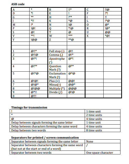

Hi guys, I've created a program that translates ASH to ASCII and vice versa. I now need to flash the ASH onto the arduino shield led pins. For example, if the user types in ASCII when the ASH translation gets displayed on the serial port it should also flash onto the arduino led.
I need to flash modified ASH (when the user enters ASCII and it gets translated to ASH) onto LED pin 5 and I need to flash unmodified (When the user enters ASH onto the serial port) onto LED pin 11. I also need to control the ASH transmission speed (LOW, HIGH speed) with the potentiometer on the arduino board.
If anyone here could offer me help it would be greatly appreciated, I just don't know where to start with it, because I don't want to do more than I have to when a function could just be modified to do the task.

NOTE: I've include an attachment which explains ASH and the timings for the ASH led flashes :)!
