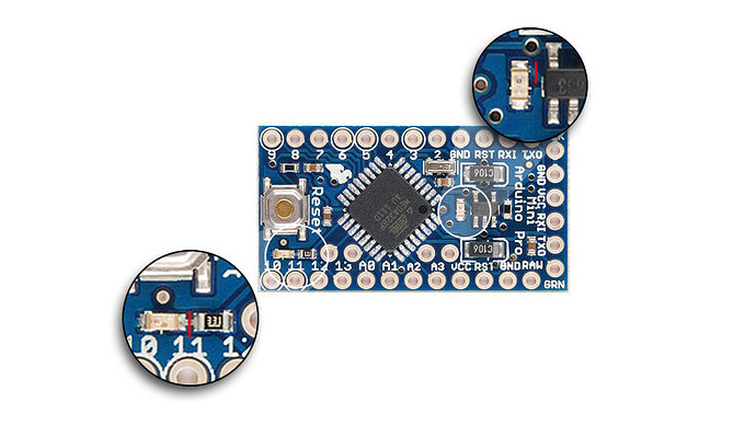

Before posting this new topic, I read alot and disabled the 2 LEDs and regulator on sparkfun arduino mini pro 3.3V board. However, I could not get the arduino board sleeps at a few micro amps as people claimed. Right now, it's sleeping at 220 micro amp. My goal is to get to about 10 or 30 micro amps or so.
Could anyone please give me a hint to get there? Below is the description that I did.

Modified hardware:

What, if anything, is it connected to?
Did you remove the regulator? You say you "disabled" it, but I don't know what that means.
Is it really disabling the ADC? I see you're telling the library to do it - but that's about exactly what you'd expect if everything else was successfully turned off but the ADC wasn't.
Try ADCSRA &=127; before sleeping ADCSRA |=128; after leaving sleep, to make sure it's actually getting turned off.

It connects to a relay to control a light bulb. The signal was cut off during sleep. I made sure that there was no other components eating up power while sleep.
I cut the trace line to the regulator but did not completely remove it.

I would measure it with nothing at all connected, first. Including any sort of serial adapter.

Thanks for an explanation in detail. I included those lines before and after the line:
LowPower.powerDown(SLEEP_8S, ADC_OFF, BOD_OFF);
Then measured the arduino board only (with no other attachment). It still says 220 micro amps. There is no different.
Is there anything else that I could try? hardware OR software ?
