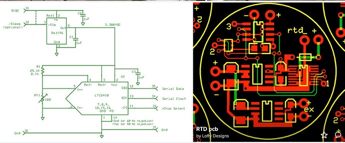

Here is a successful use of a 24-bit ADC I did a few decades ago along with a picture of the PCB art. I have no idea where the files are.
