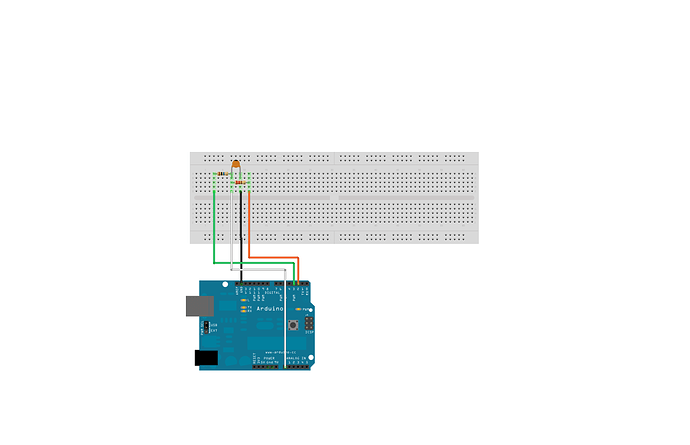

So my problem is that after a week and lot of tests, I've not found the way of getting it to work synchronized with my Termo-hygro-meter of ~10 euros.
First of all, I want to know if it's possible to make it work accurately (+- 2%), or just think it's working well. Because at the momment, when my termo-hygro-meter marks 33%, my sensor + code says: 39%. And when it's 41% it says 39%.... I am getting a bit crazy, and I think it's problem of my circuit.
So, if you have read my first link, you can know which is my circuit. The cable is not longer enough to loss data,
and I've been trying to get the MIN (0%) and MAX (100%) values for the Analogue Output. But, I can't leave it as done, because it's obvious that it isn't.
or I just can use an interrupt timer2 (or someone available), for doing the trick, or...
I ask you because I have no much idea, and because the first link, says you can do both ways... but the result is obviously a fail.

And my circuit is:

Did you see the link in my Reply #1 ? and do you have a few resistors to test it. Do you get some values out of that sketch ?
You can put a damp cloth (not wet) on the sensor to see if something changes.
Oh, sorry. I missed it. Just already open.
I saw this sketch before while trying to get something clear.
Do you think this sketch is better idea than my actual one? Just to be sure, do you suggest me to try to calibrate the sensor by using the same circuit and sketch? Just doing the same that I did with my actual, (the way of calibrating by myself), would I get a better result? I see some light at the end of the path... :open_mouth:
Answering your question: yes, it's obvious to my eyes that the sensor is working, I can't ensure if it's working 100% well, but at the moment, it reacts by changing its value when the humidity changes. Example: breathing near the sensor, makes the output higher, and putting inside the bag with dry towel paper makes the sensor to output a lower value.
The problem is maybe the circuit and the sketch, which can't read well the variations, and only works with very higher changes...
Thanks Peter, I am going to try your suggestion (new circuit and code) but this time (because as said I saw it 2 days ago), I think I know what to do with the values of the "result" variable. :wink:
Another thing: do you think that I can "simulate" or to do something "similar" as the TLC555 would do, but without it? Even using more resources of the arduino, and doing a hard way coding... I am good at coding I think, but very bad in electronics because I never went to university. But started coding since very very young for computing. I know arduino is more powerful than the common way of coding, (IDE and C++), but ok, maybe it'll be very tedious... anyway, don't worry too much about this.

In that schematic in Reply #1 is no +5V wire, because the Arduino charges and discharges the capacitor.
When you have a few samples, you could use the "MultiMap" to translate them in humidity percentage.
http://playground.arduino.cc/Main/MultiMap
In the reply #5 there's the schematic that I am using right now.
In the reply #1 I can not see any schematic, just is asking for documentation about the sensor, and a sentence more.

The wires are just 0.1 mm thick, and ~16cm long.
I use 2 wires, brown and green. Green is Analogue Input, brown is GND.
I used 220Ohm resistor in serie with a 1Mohm resistor in pararlel with the cap. HCH-1000 is the cap.
This humidity sensor, is crazy accurate, faster and bravely optimized. But I must recalibrate again. It's over 6% difference between "real" measurements, and between a range of 23% and 42%.
