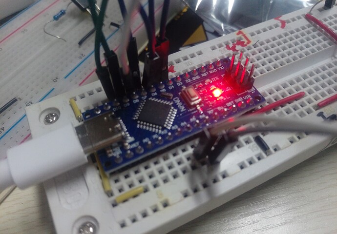

How to hardware debug Nnao?
How to debug Nano with Atmel ICE on Ubuntu? Anyone has used this?
Let's start with the basics
Exactly which "Nano" do you have ?
That depends on which Nano you have and does that chip support any of these JTAG, SWD, PDI, TPI, aWire, SPI, debugWIRE and UPDI interfaces?
MEGA328P U-TH
