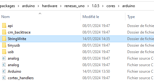

Hello all.
I have a custom library called StringWrite (derived from SD library) that I want to put on minima core folder like this
the content:
utility folder content
StringWrite.cpp

But, the problem is when I try to test the function, I got this compilation error
So I tried to manually add the "SPI" path library folder on my StringWrite.h file ("../../libraries/SPI/SPI.h") and I got this time lot of error:
The thing I don't understand is that, when I decide to put my custom library folder on the default Arduino Library folder, everything goes right, compilation success.
So I have the feeling that SPI folder and other make problem when I put my function on arduino cores, but my programming level is not enought to understand why.
So need help to solve it please.

Why does the library need to go into the minima core folder rather than the standard libraries folder ?
Because I soldered an SD card slot on my minima, so I'll use everytime this function. So I want to make this function a default one, like function we see on core folder
it uses other libraries SPI and SD. core can't use libraries.
so there is no solution to make core use libraries ?
maybe @ptillisch have a solution for it ?
Ha, thank you @Delta_G
That is what I didn't get !
I think the big problem is I don't understand what is the difference between the core and libraries standard folder, because There is also a library folder in the cores folder... how does it works.
