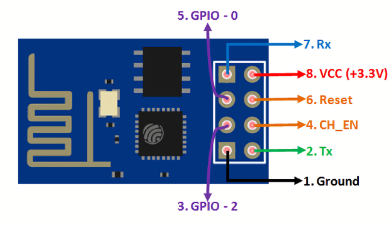

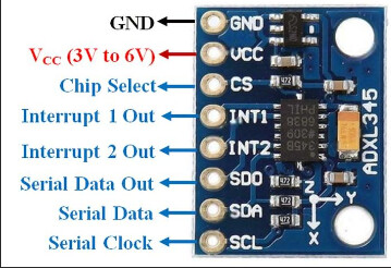

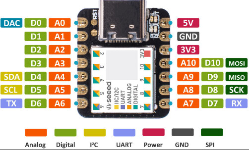

I am having trouble connecting these modules. My target is to send accelerometer data from the ADXL345 via the Xiao and the ESP8266-01 to my laptop. I have searched for the connectivity to no avail. Could you provide any help or guidance?
connect
  1. the ADXL345 to the Xiao using I2C
  2. the Xiao UART to ESP-01 UART
  3. the ESP-01 to WiFi
or
  1. the ADXL345 to the ESP-01 using I2C
  2. . the ESP-01 to WiFi

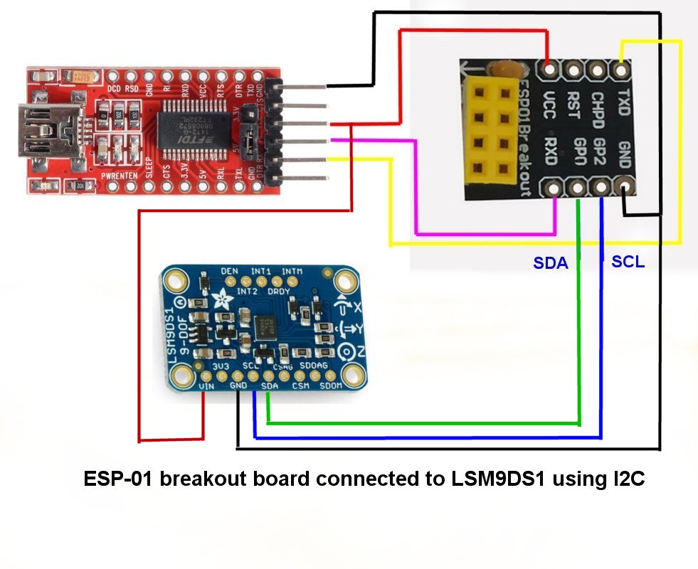

have a look at cayenne-mqtt-and-standalone-esp8266-esp-01
to check the ESP-01 I2C I connected a LSM9DS1 (9-axis iNEMO inertial module (IMU): 3D magnetometer, 3D accelerometer, 3D gyroscope with I2C and SPI) sensor and tested with code
// ESP-01 (ESP8266) test of LSM9DS1 sensor
// connect SCL to GP2 and SDA to GP0

wiring the LSM9DS1 to the ESP-01 using I2C
esp8266-01
These are the components I am using. I want to send the accelerometer data to my laptop
Why not simply the project and get a wemos D1 mini?
Thanks, I have a wemos D1 mini but I wanted a smaller component because of where I am going to place it on a tool
do you require the Xiao?
why not connect the ADXL345 directly to the ESP-01 using I2C
then use the WiFi to transmit to the laptop
but Xiao + esp-01 is larger than Wemos mini
Can you help with the pinout or the connection. how do I program because I am not sure the ESP-01 has a microcontroller.
Yes, is larger but I am looking at the width
Every ESP is a microcontroller. It is the same microcontroller as wemos mini, but with fewer pins. It has only 4 GPIO pins. One is RX, another is TX, and there are 2 more GPIO which can be used for SDA, SCL.
what do you think is ecxecuting the code of the program in post #3 reading the LSM9DS1 sensor data and displaying Acceleration etc on the serial monitor

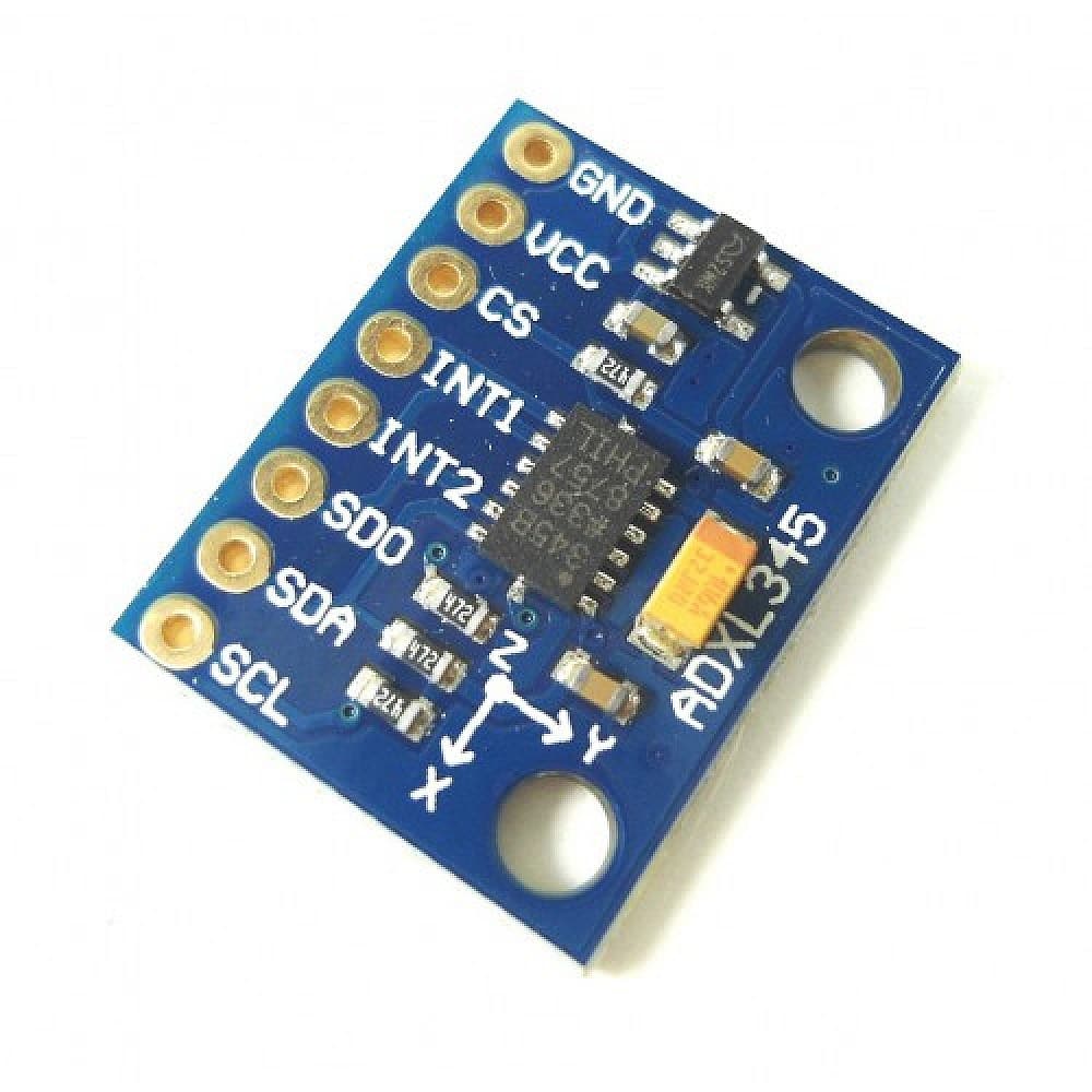

I encountered some difficulties when trying to program my ADXL345 breakout board with ESP8266 nodemcu. It gives the error below.
Nodemcu ADXL345
SCL ---------------SCL
SDA ----------------SDA
3v3 ----------------- VIO or VS
GND ------------------ GND
Soft WDT reset
>>>stack>>>
ctx: cont
sp: 3ffffdf0 end: 3fffffc0 offset: 01a0
3fffff90:  3ffee648 3ffe8946 3ffee7a4 4020134c
3fffffa0:  3fffdad0 00000000 3ffee7f8 40203158
3fffffb0:  feefeffe feefeffe 3ffe85e0 40100e21
<<<stack<<<
--------------- CUT HERE FOR EXCEPTION DECODER ---------------
When I used the same connection and code for another ADXL345 shown below it worked well
