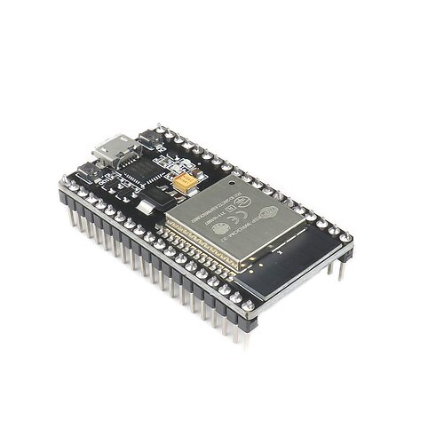

esp32 i am using :
https://robu.in/product/esp-wroom-32-esp32-wifi-bt-ble-mcu-module/

i got it running with an arduino uno using the dmd2 library , but wasnt able to run it with an esp32 .(i did change the definition of pins , and no use )..
should i use a voltage level shifter ? or some other sol.
the adafruit library is for HUB75 where inputs and connections are different ,.not much use.
That is the first thing I would try.
If the led panel runs at 5V, the 3.3V signal of the ESP32 might be too low.

no i did not need a voltage level shifter for it. Input works fine with 3.3v . although you can still use it for safety purposes.
you just need to download the esp32 firmware in boards manager to 2.0.2 .
I referred to this issue: panel not working!dmd32.
i downgraded the firmware and it works fine now . thanks !
