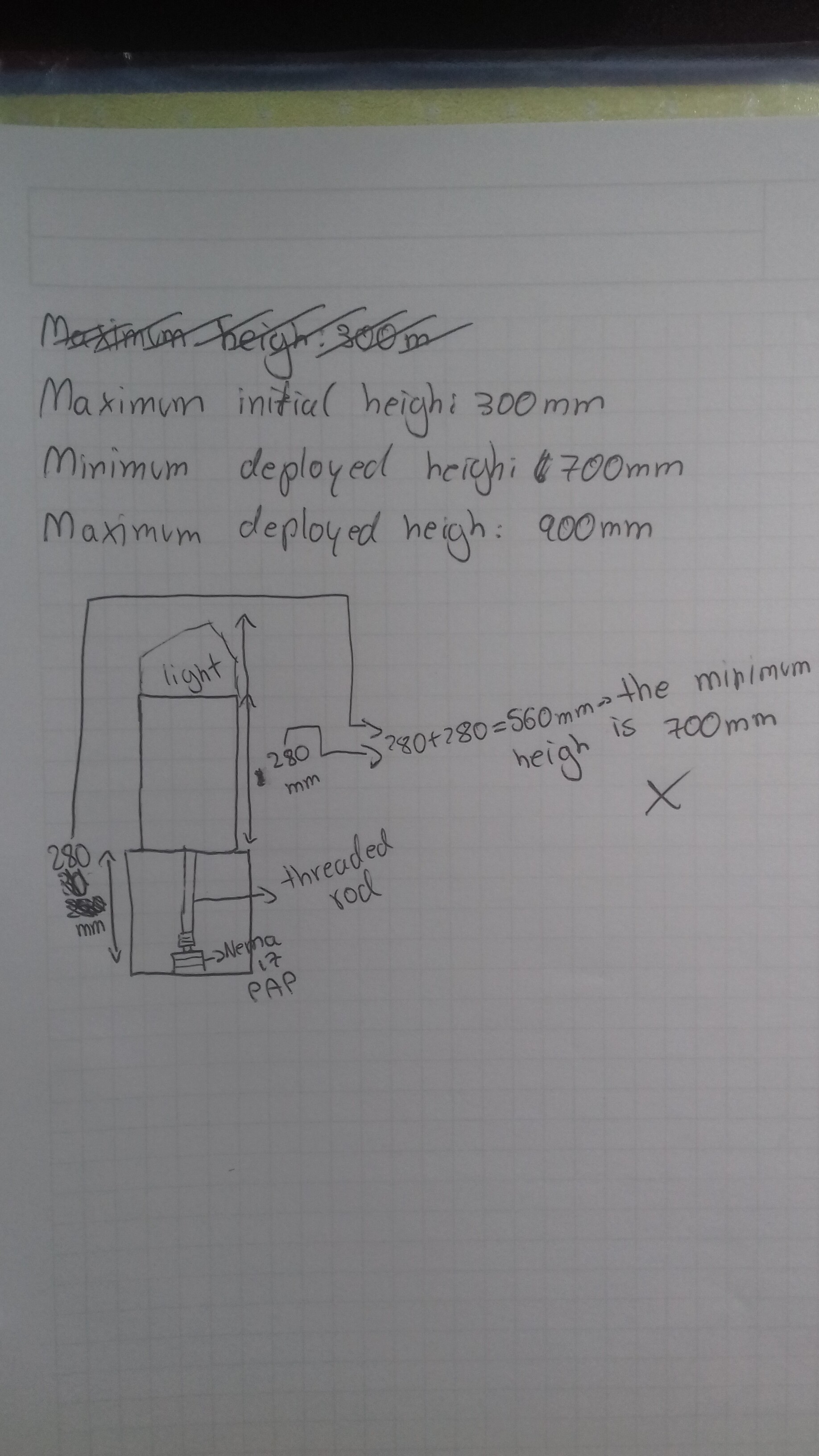

I cannot use a linear actuator because the rod would protrude above the headlight, and I want a system that does not protrude from inside the headlight
I think you have a misconception of how a linear actuator works.
The shaft of the actuator "TELESCOPES" out of the end of the unit like a hydraulic ram moves in and out of a cylinder.
The rod will not protrude above the top of the lighthouse.
How much space have you got under the platform?
Tom.. :slight_smile:

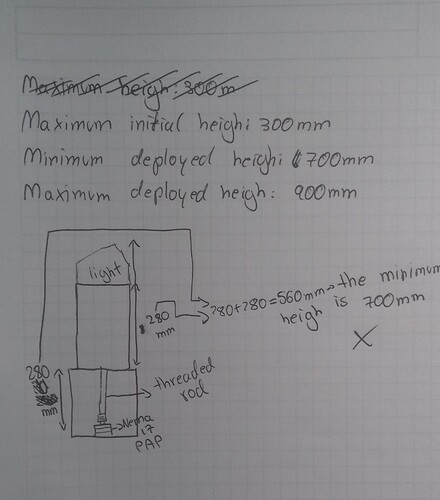

I make a diagram explaining why I think a threaded rod would protude above the highest point of the lighthouse:
You might look at this scheme to make a telescoping mast, and put it inside your lighthouse. You can add as many sections as you want.
Use the Arduino and a H-bridge to control a small DC motor to act as a winch to pull or release the cord and make the lighthouse rise.
Paul
Thank you so mach for the showing me the system of the telescope, I will use it, now I am making the designs in Fusion 360. When I finish the design I will post the results. I hope I would finish the designs today or tomorrow. :slight_smile: :slight_smile:

I have to make a lighthouse of 300mm maximum at the beginning and with a push botton I have to activate it and make it to rase vertically, I don't now what mechanism would be usefull for this project. Any idea ??
Two designs that might be considered are a scissor lift mechanism and a telescoping pole setup that is operated by a cable. As to using air in a telescoping tube setup, instead of sealing with O-rings, you might make an internal bladder out of thin plastic sheeting. If the tower is thin, you might push it up with metal cable. There are probably more complex ideas available
