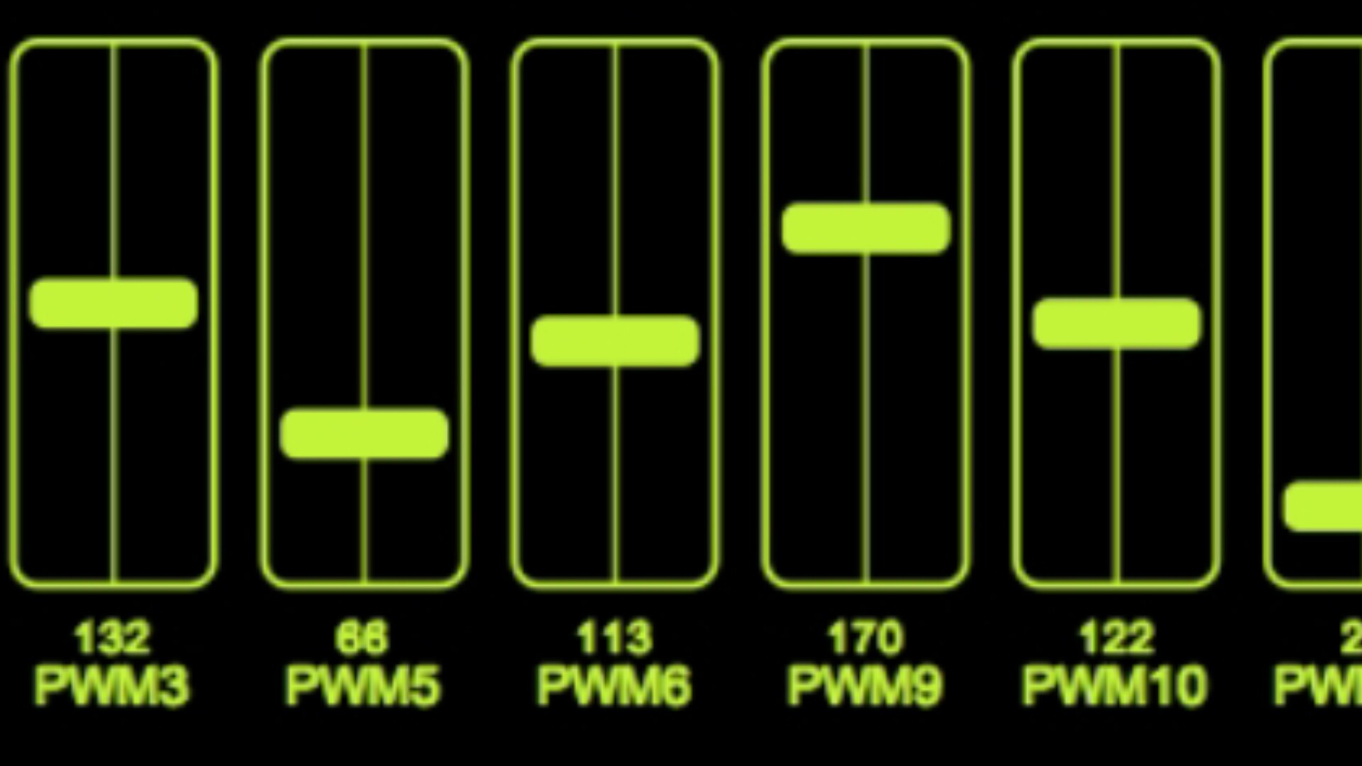

Im using UTFT & URtouch libraries with arduino mega
And ili9341 driver screen
I want to make a setting screen for changing program varibles
Something like the photo attached
How can i make a function that will draw the slider
And in the loop will update the varibles
I need it to be a function so i can make many sliders with only small changes
Can someone give me some support with it ?
If there is a link to a library contain such slider it can help me as well ![]()

David i work on the draw slider and even make it better than it was on the picture
and now the function i made is drawing sliders
but i really need help with the function that update the slider
i want to make a Red nittle or line at the left side of the slider and that it will move
and update global varible every time i touch the slider can you help me with that?
