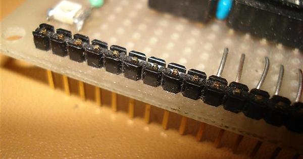

I made a line following robot shield (its in the project forum) and while I was making it I had an extremely difficult time soldering on the pin headers that go into the arduino. I decided to scrap the headers and use a thicker wire to do it. The problem is that the top on the pcb has the parts on it , the bottom has the copper and the parts soldered on it, now if you think about it , you can't put on headers because you have nowhere to solder them to.
Anyone have any ways they get around this problem?

Trick 1: use longer than usual headers, put 'em in from the back side. If they're not quite long enough, press down on the plastic part so that there is none of the pin left sticking out the bottom, then solder.
Trick 2: solder them in upside down, with the plastic up in the air. When finished soldering, shove the plastic down to the board.
Trick 3: put the headers on the back side of the board. If you use right angle headers, it doesn't really mess up the mounting and aesthetics (a term that doesn't really apply to my own home-etched boards) too much.
Trick 4: put the pads for the headers on the edge of the board, and use straight headers for a horizontal mount, or right-angle (RA) headers for a vertical mount. (bonus: no hole drilling required!)
The easiest way to do it, though, is to use SMT headers, like KE7GKP mentions. They take up more board real estate, but you don't have to drill holes which makes the PCB fabrication a lot easier, IMO.
In a pinch, RA headers can be used as SMT headers. They need extra room, or trimming, though.
