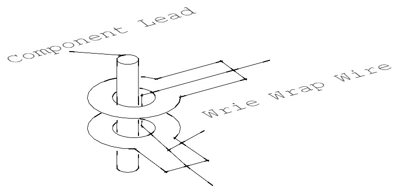

I sometimes use stripped wire wrap wire (30 AWG) with holes that cannot be easily accessed. I solder the wire to the top and bottom traces away form the pads, then add the component (ex: relays) and solder the bottom pad completely. This way the bottom pad is connected to the top trace by way of the wire wrap wire. (hope that makes sense)
