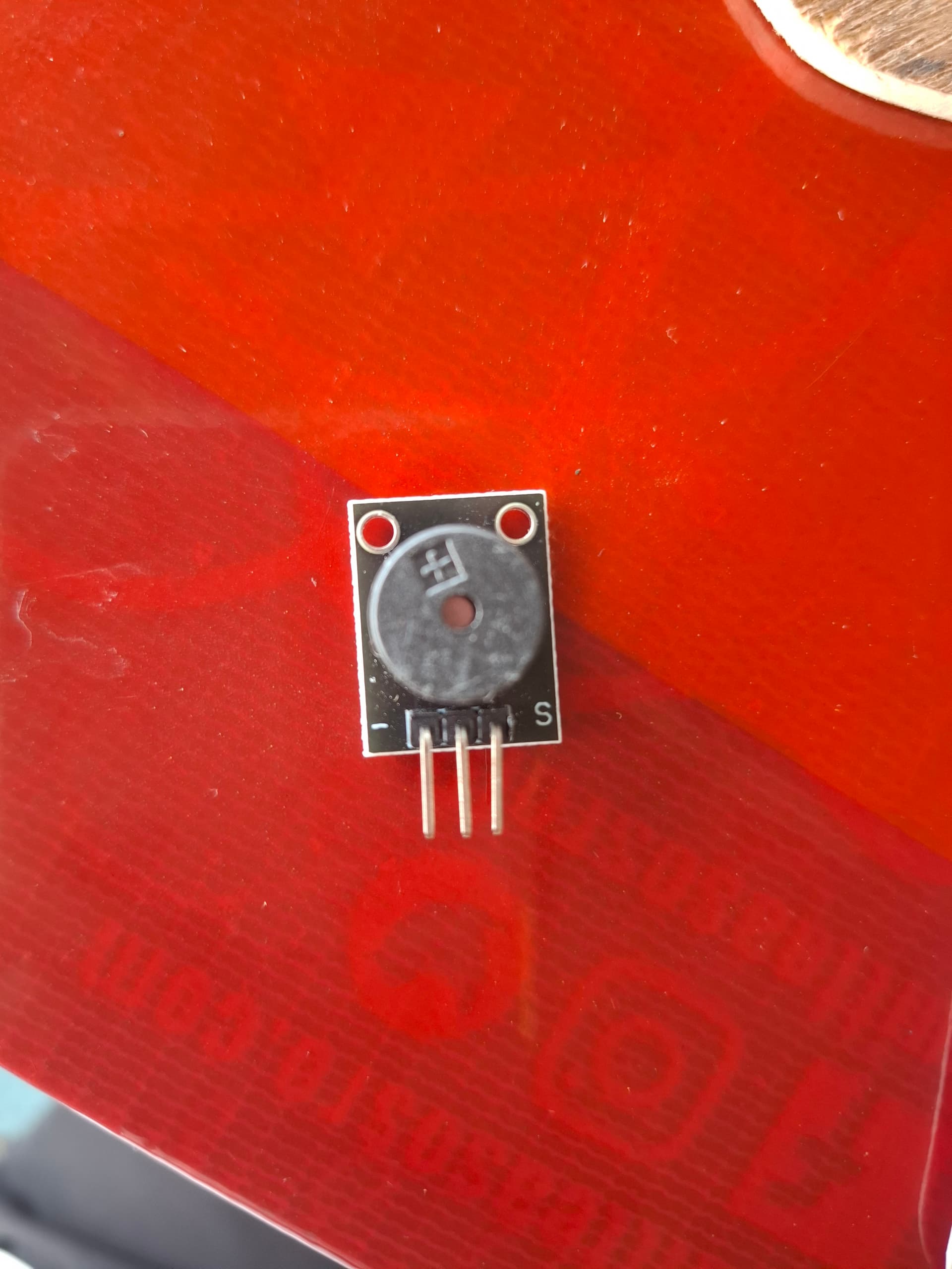

iam using a passive buzzer like this one
iam trying to make it sing the song happy birthday, yes it work but the volume is so small. is there a way to make it louder?

I've never seen a (presumably) piezo sounder on a small PCB like that before.
Piezo Sounders usually have only 2 pins but your board has 3. Do you know what the 3rd pin is for? Is there some other circuitry on the rear that we cannot see?
from what i search it is called esp32 buzzer. 1 if for gnd, 2 is for 5v, and 3 is for the digital pin
Looks like KY-006 . Middle pin is not connected.
You could use NPN transistor to drive it at higher voltage (and current).

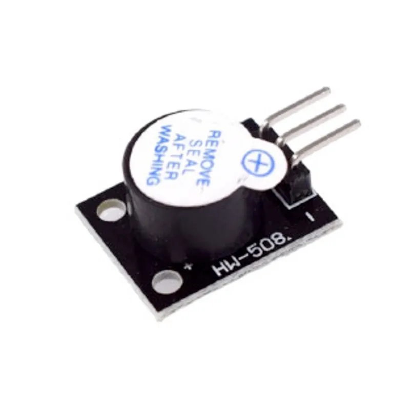

From @krisi0506 's description, I think it is this:
In which case I don't think there is anything you can do to make it louder.
But this board is an active buzzer, which means it's frequency is fixed and you cannot play a tune.
I would consider one of those tiny amplifier boards and a regular 4 Ohm / 8 Ohm speaker to replace your buzzer.
EDIT: on closer inspection, the page I linked to above is full of contradictions and clearly unreliable.

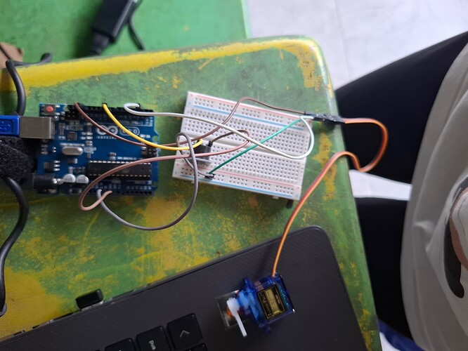

Which Arduino are you using?
Where is the 5V pin connected to?
Do you have any transistors or MOSFETs?

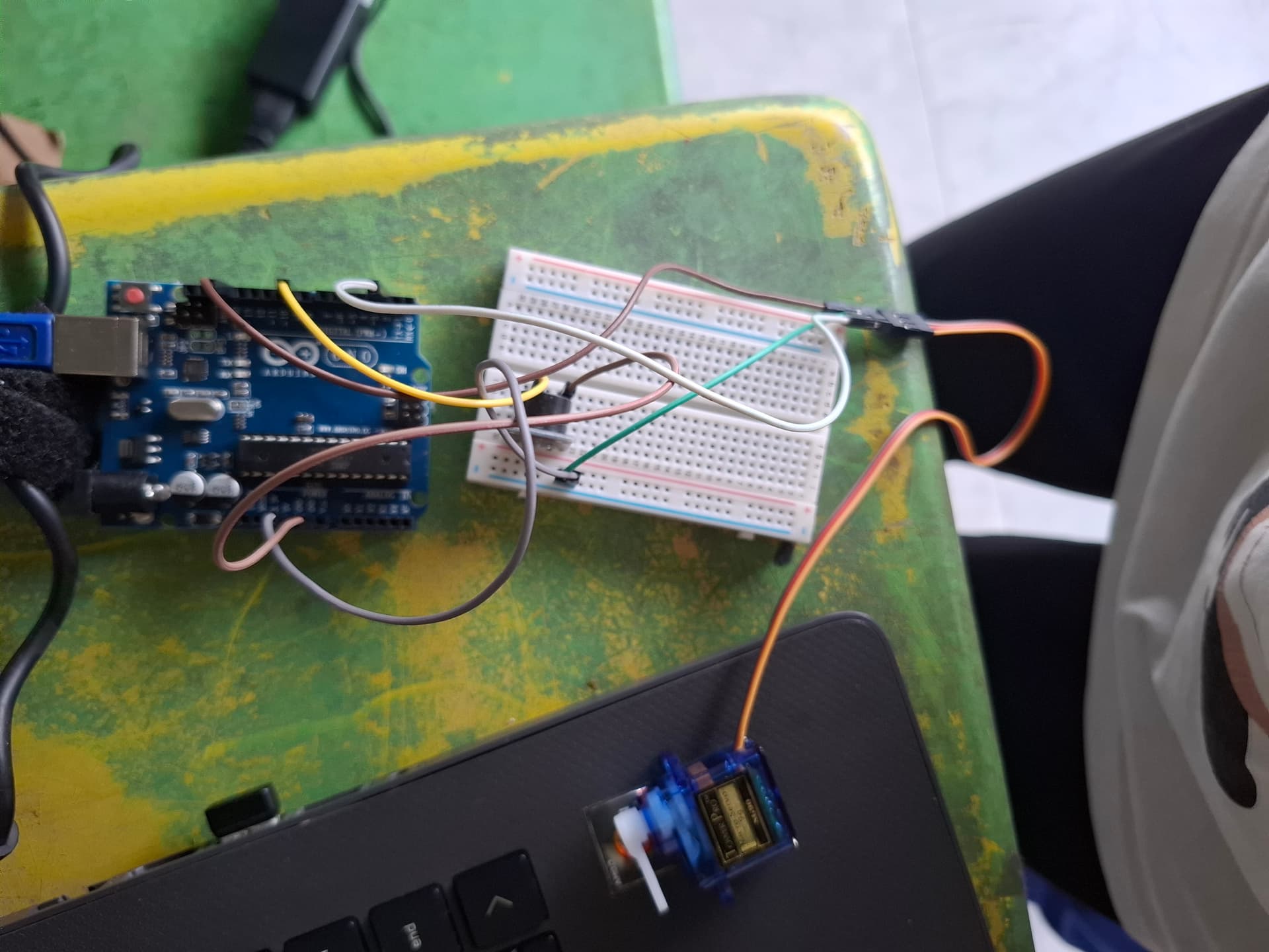

i wanted to make like a funny repo looking robot that open its mouth and it will sing the birthday tune, yes it work but the volume is so damn small ![]()
Assuming it actually is passive, try the toneAC library.
This library requires you to connect the buzzer to two pins.
It drives the buzzer in bridge mode for twice the voltage on the buzzer.

No.See post #8 and #12
If I have identified it correctly from your description, it is an active buzzer. But to play a tune you want a passive piezo sounder. These are round and have 2 pins. They can plug into your breadboard. You don't need one on a PCB.
