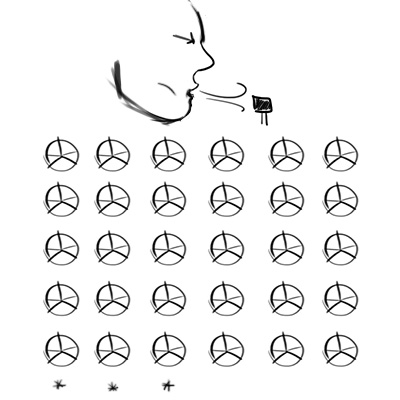

The project is to build a series of fans, around 30, (doesn't need to be CPU fans, can be just motors holding a strap of plastic or card), where i blow into a microphone and it outputs the force to the fans making them start.

I need to control them independently,(sort of: they will be stacked in columns) but i do not need to control the speed.
Because they will be stacked in columns i do need to control which columns should i activate depending on the force of the blow. (hence the sketch : the asterisks show an example of simultaneous columns that need to be activated at the same time ranging from 1 to 6 - 1 column min, 6 activated columns max).
Is it easier to treat them independently? or can i group them in some sort of shields or control drivers? (or am i going totally the wrong way?)
Thanks,
Hope i gave you all the info you need.
6 columns of fans is easy to control with 6 digital pins. These Relay SPST-NO Sealed - 30A - COM-00101 - SparkFun Electronics
along with a few simple parts make it easy to control the fans.

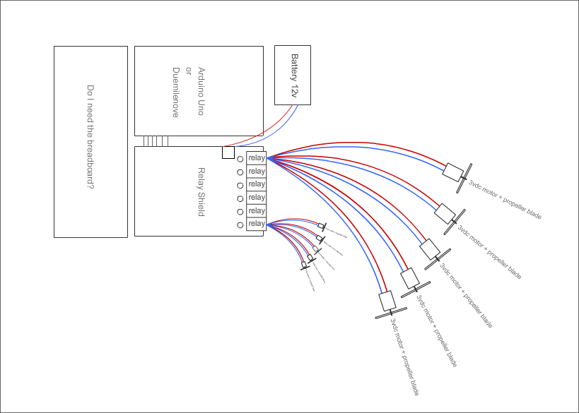

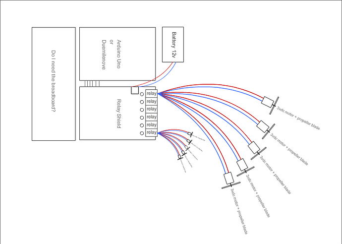

EDIT: i made a sketch to know if i got things right.....

I think i know what to do now... i'm ordering the stuff i need:
1x arduino uno
1x relay shield (with 6 relays)
1x 12v battery
30 x 3vdc motors
30 x 4" propellers
and i think thats all i need.
could you comment on the "very professional" scheme i drew to know if i got it right?
Thanks :slight_smile:
1x 12v battery
30 x 3vdc motors
Why do you think you need 12V battery for 3V motors?
Should be the same.
the relay shield only operates at 12v or did i get that wrong?
Yes, you are right. Will be arduino powered from the same 12V battery?
It would make sense, to order 12V motors, so you will need only one source of power for all staff.
I was thinking about powering the arduino through the usb cable, as i need to send data to it at runtime....
Any tricks i need to know to not kill my board when doing this?
Arent 12vdc motors overkill for a simulated fan? they cost so much more...
pc fans run on 12vdc right? maybe its not overkill. maybe i should just buy pc fans instead of motors and propellers....
I'm thinking, if arduino would be connected, instead of battery you should use power supply plugged in AC outlet. Relay usually drain a lot of currents, and battery probably, would discharged too fast. If 12V motor is expensive, than you can go with 3V motors and buy separate 3 V power supply. So you would need two of them, 12V for relay board , and 3V for motors.
Other option to eliminate 12V from a map, is find a relay board that could be powered from arduino +5V, and it should consume less than 500 mA.
