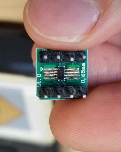

I just received the IC and soldered it onto a board.
I made sure there were no shorts between pins by doing a continuity test. Is there a way to read the resistance value from a digi pot via 3-wire spi? The table in its datasheets states that it has resistance readings based on the 8-bit digi code you send it.

No. It also won't work as a pot unless it is powered.
Since it initialises with the wiper at 1/2 the full scale resistance and…
you are the only one who can change that, by sending the only command it accepts,…
it is up to you to remember the last thing you told it. That's what it is set at.

I ended up measuring pins B and W with a multi-meter. I believe it is working since changing the 8-bit digi code to 255 gives me 10k ohm, and I am using a 10k ohm digi pot. Now I think I just need to correlate the resistance values to the voltages I want to output.
If you are just using it to control some voltage, you are re-creating a DAC, the hard way.
Sounds like.
You could have some fun and put A on Vcc, B on GND, and then feed W to an analog input.
Write a little sketch that slowly feeds increasing numbers 0 to 255 to the digipot, and measure with analogRead() the voltage at the wiper.
