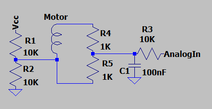

I have an out of two-wire which provided approx 5Volts which is generated based on the shaft direction.
for understanding, I called It to wire A and wire B
In the static condition, it gives zero volts.
If it moves away from its position wire A have -ve voltage and wire B have +ve
if it moves inward from its position wire B have +v voltage and wire B have -ve
is there any way to read always +ve voltage making other wire as groud using Arduino?

To measure positive and negative voltage swings with Arduino, you need to shift the operating point to Vcc/2 (bias the input). This limits the allowable swing to +/- 2.5V on a 5V Arduino.
The circuit below should work. R4 and R5 form a voltage divider to reduce the motor output voltage by a factor of 2 (you stated +/- 5V output, maximum), and R3 protects the ADC from inputs greater than 5V and below 0V.
