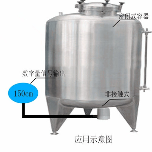

I bought it from this link.
https://www.aliexpress.com/item/Ultrasonic-switch-sensor-Ultrasonic-level-meter-induction-switch-Non-contact-liquid-level-sensor-metal-container-liquid/32826849007.html
Other than it's shocking price, that's a very interesting sensor.
It is just glued to the bottom of the container, right?
Where's it's data sheet or manual?
Housing indicates it's weather proof but no claims of that on any of the many sites that sell it.
No information on how to read this sensor, at all. It's also known as DYP-1603.
It apparently can be use as level switch if mounted to the side of a tank, and as absolute level sensor (no word on calibration; unsure whether the wall thickness has any effect) for 50-1000 or even 50-2000 mm liquid depths when mounted on the bottom of (i.e. beneath) the tank.
There are various versions of the sensor: DS1603AQ (analog output), DS1603NF (level switch - only a high/low signal), DS1603DA (UART/Serial output) and finally DS1603L which appears to have UART output, and a fifth wire marked "OUT" - my best guess is that this is meant to be a level switch.
And here you go, something that closely resembles a manual on this page. The UART is apparently 9600 bps TTL compatible (provided you supply it 5V it should never get over that voltage, and it apparently will also work on 3.3V). Quite irritating that the text is in the form of images so Google Translate doesn't work.

Oh, continuous stream of data. That's why that header, then. Makes sense.
255 - 0 - 0 - 255 would be a single set of readings (header, data_h, data_l, sum). That's when the sensor is not attached to a container filled with liquid, right?
The first set of numbers doesn't make sense to me. It should for starters be series of four numbers.
@wvmarle Thanks very much for your contribution.
I connected the sensor directly to arduino and like you said, 255-0-0-255 means no liquid present.
When liquid is detected it outputs a fixed 255 and three other numbers depending on the height of the liquid.
I'll just have to do some calibration with different types of liquids.
The package came with a glue(fluid), which I had to apply on the surface of the container before it could detect the liquid present.
Thanks so much wvmarle!!! :slight_smile: :slight_smile: :slight_smile:

You mean you held it tight up against the bottom (outside) of various containers? Did you use the adhesive? Seems like it probably needs the adhesive for proper coupling.
Did you try steel containers? What wall thickness and size?
But anyway, it is a bit hard to believe this could work (finding fluid depth when mounted on the outside of a vessel)...especially if the wall is thick.

Also, it would be interesting to hold the "business end" of the sensor slightly under the water surface (at the top of the container), pointed down toward the bottom of the container, to see if works as a typical "sonar"...bouncing a signal off the bottom of the container.
I tried a glass and a plastic container, no adhesive. I suspect that to be the problem (I suppose it's not just because that they add the stuff to the package, even though the Taobao listings don't mention it). Final application is for metal containers, just hoped to get some readings on the bench before committing to gluing it on to one of the containers.
It's for 1.2 mm stainless steel containers, max about 30 cm of water. That's all well within specs and expected to work fine. A second practical issue is the rather short wiring, which I have to do something about - and then waterproof the joint as it's an outdoor application. That's also why I didn't want to start gluing and so just yet.
You could try some K-Y jelly or similar as a temporary coupling material (before committing to the adhesive). Our ultrasonic thickness gauges (for measuring the thickness of metal components) use a fairly viscous fluid like that.
