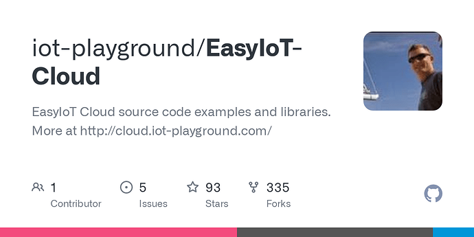

JMeller...I'm a few days into 8266 myself and have the Blink and Webserver working. I found this link which might be useful to you and it's the direction I'm headed:
however I'm having trouble getting the MQTT files off GitHub from their link.

pert...not wanting to interfere with OP thread...but, I cannot find a "download' button to click on at this link:
JMeller...thanks for suggestion, but tried that earlier, but cannot find the same library source under Manage Libraries, only by Adafruit

Did you try this?
MosheB...thank you. I saw that one, but the folder name inside was slightly different than the link in the article, i.,e., EIoTCloudRestAPi and was not sure if it was the correct one...but, if it's the only one, I guess it won't hurt to try it.
