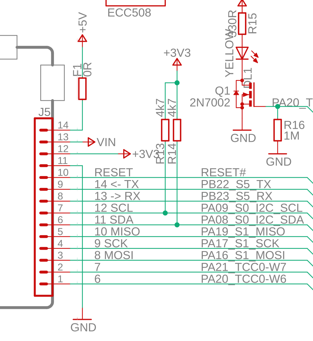

If I'm interpreting this schematic correctly, there are 4K7 pull-ups on the SDA & SCL pins of the board
But... setting the SDA pin to low should still result in 0V output. Please post a schematic showing how the pin is connected, and a link to the specs of the relay board. Could there be a pull-down resistor on the relay board?

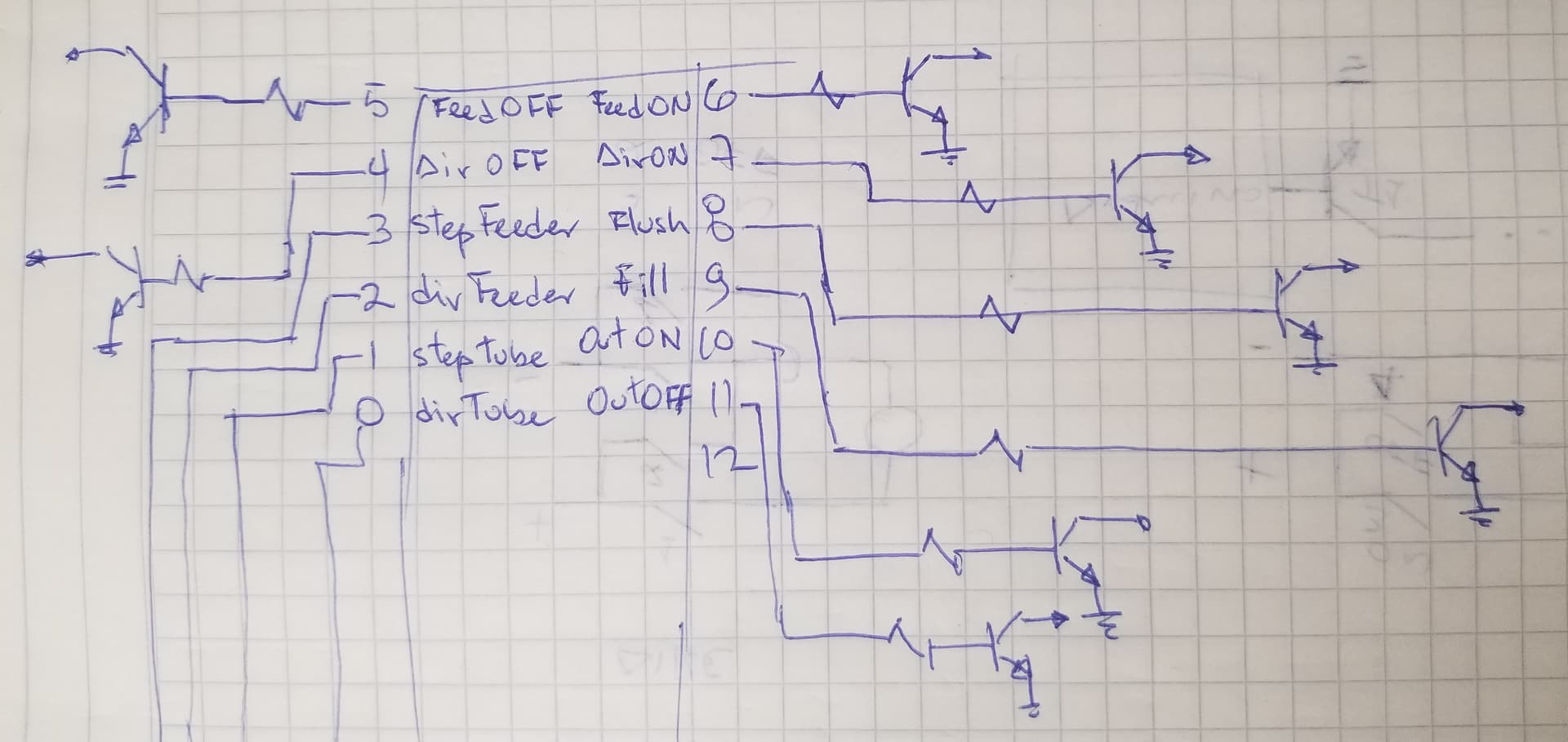

Thanks for your answer, I am using 8 pins of the GPIO to control the relays(SDA included), all other 7 pins works without problem, I am enclosing a hand drawing of how I am connecting the GPIO to the input control of an "Arduino relay module"

I try connecting in a protoboard only the circuit with the transistor without the relay and still I obtain that 1 volt at the output
