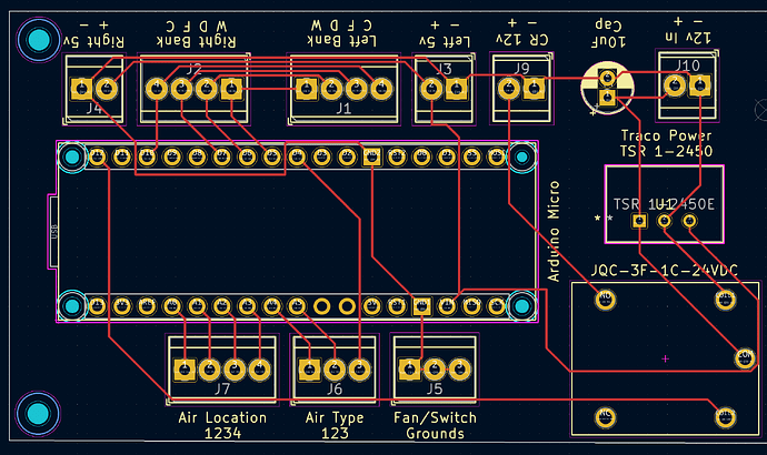

Hello Friends,
I'm hoping that a fresh set of eyes will see something that has stumped me for the past few hours.
I have an Arduino Micro that's being used to control a bunch of small servos. The Arduino is powered by 5v coming from a DC/DC voltage reducer which receives 12v. All the servos are powered from this 5v source and not the Arduino.
I have one pin (12) set as an output to a relay that sends 12v to another device.
The problem is that pin 12 is only outputting ~1.28v when set to HIGH. On LOW it outputs 0v.
I know the relay is working because when I jump it with 3v it switches.
My 5v pin reads 5v and my 3v pin reads 3v. My VIN pin is receiving 5v.

It's extremely unlikely that an arduino pin can source enough current to drive a relay. I think you just proved that it won't do so with your particular relay!
You need a transistor or a relay driver.
This is a 3v relay for Arduinos. When I jump the relay with my 3v pin it works fine. The issue is that my OUTPUT pin (12) isn only sending ~1v to the relay and as such it's no switching.
I don't know why pin 12 is only sending 1v.
Can we have a link to the specs? What's the current requirement for the relay coil?
What's the voltage without the relay connected?
For help, please post some actually useful information, like a wiring diagram (hand drawn, with pins, parts and connections clearly labeled) and links to all the components.
You have almost certainly made a wiring error.
This is the relay
My PCB is here:
It's all about coil resistance.
If the relay (coil) is out of circuit, what's the story on "pin (12)" ?
The data sheet says the coil power is 0.36W to 0.45W, so at 3V that is between 120mA and 150mA, way more than any micro controller pin can provide. You also need a diode across the coil otherwise the first time the relay turns off the resulting voltage will kill the pin and possibly the processor, see:
You need a logic level MOSFET to drive the relay. I suggest you build the circuit on breadboard and make sure it works before committing to a PCB.
Post the schematic instead of the PCB image.
But, the obvious design error has already been identified. If the port pin survived that abuse, consider yourself very lucky!
OP's microcontroller might have survived it for now but I would never put it in a production batch for customers.
From experience, abuse can result in a slow killer.
