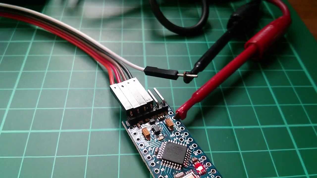

here is an interesting vid on youtube regarding the operating current of 328
