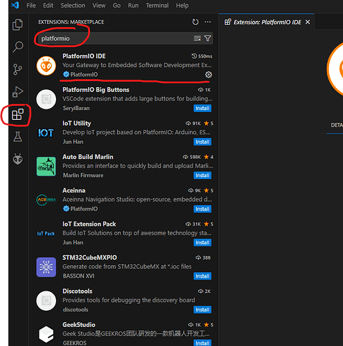

  3. After installing Visual Studio Code install the extension platformio
    platformio will also install c/c++ for you. So dont worry about that.
