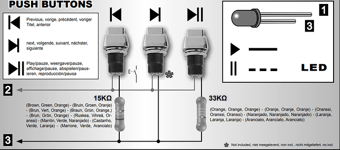

Well, I went to the next level, forgot about the arduino for now, and opened a MP3 jukebox module that I had bought a while ago.
Turns out I'm able to play stereo music, but I'm stuck with the push button configuration.

The MP3 player board differentiates which button is pressed by the resistance between pins 2, 3.
As such, solderless breadboards and dupont jumpers can introduce erratic behavior.
Use you DVM on 2 and 3 then push the buttons: you should be within 5% of the values stated. My experience with those cheap little push-buttons is abominable.
Thanks, I tested the pins 2 and 3, (lane red and blue on my schematic), and the default resistance is 27 kOhm, then it drops to 12.3kOhm when pressing button "Prev", and it only drops to 18kOhm when pressing "Play/Pause".
As for "Next", it drops to 0, as expected. So I guess, I have to compensate for the LED or something, as it may have been thought as "optional" ? I will try my own resistors rather than the provided ones.
I Tried increasing the overall resistance to make sure it could drop to 33kOhm, by adding a 47kOhm on the purple wire (lane 3). Then, I replaced the 33kOhm resistor to a 47 kOhm resistor (I broke the 33k one, and have no replacement).
Surprisingly, checking the resistance between pins 2 and 3 gave good results:
  • 77k with no pressing.
  • around 14k for button "prev"
  • around 32k for button "Play" (which is weird, though, right?)
  • around 0 for button "next"
But, it didn't solve the problem, and now, even the "next" button does not lower the volume.
