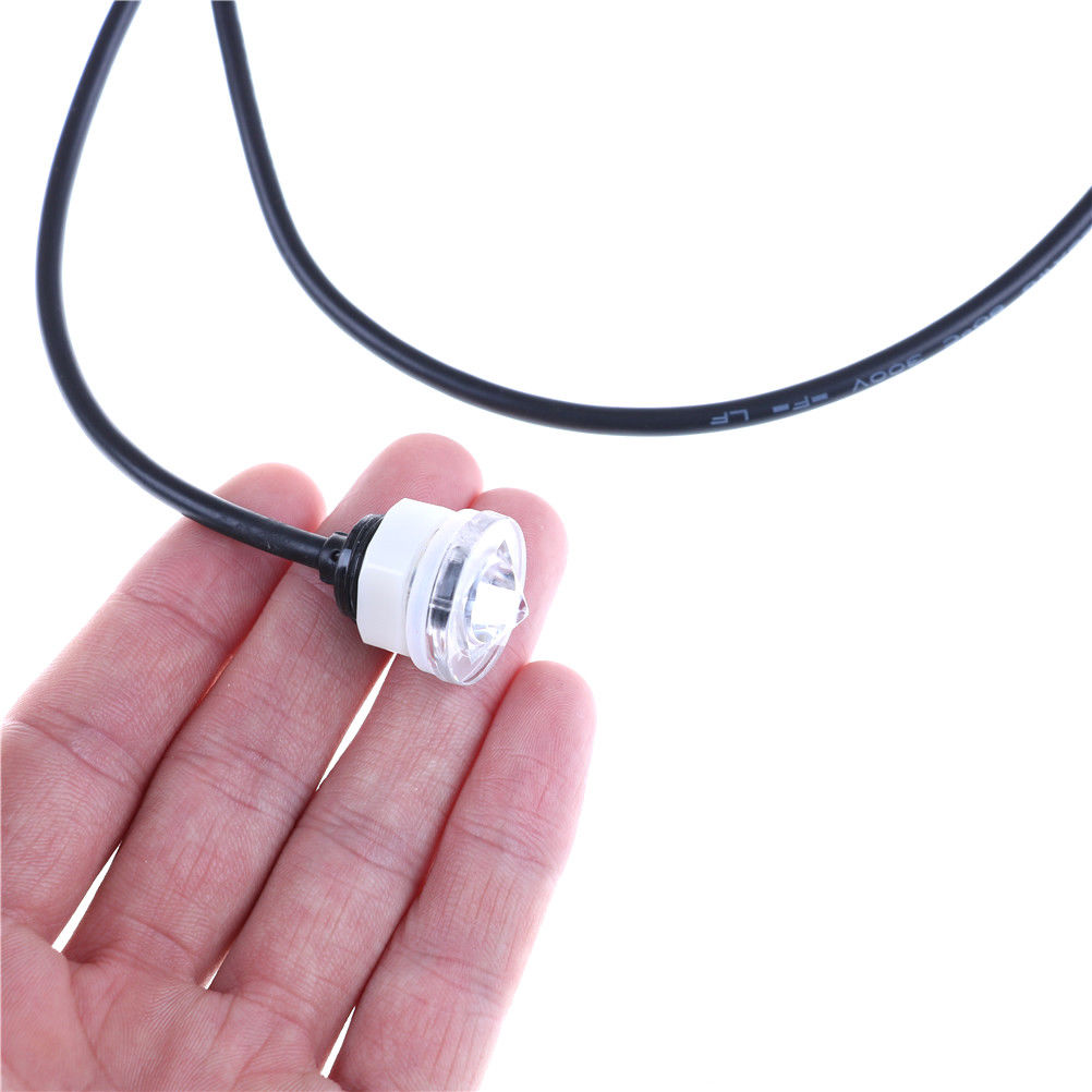

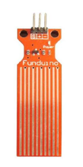

Hello, I have a Liquid level sensor (RB-02S048) that I am planning on using to detect the water level in a closed vessel that will be dispensing water. I still have not designed the vessel because I am not sure how much of the sensor can be submerged or how to cover the area that can not be submerged. I have searched for examples but haven't found anything similar. Could someone please help with this dilemma? Thank you in advance

Here is a level sensor which you bolt into the side of the container at a particular level which allows you to detect whether the water is covering that level. It - unlike the float valves - has no moving parts which means it cannot release particles as it "wears".

I have used some industrial versions of the optcal sensor in post #1 and they are very good.
Especially with fluids that are conductive and need a non contact sensor.

The vessel is for dispensing water to an obstacle avoiding robot that will also clean floors. The robot will be programmed to stop once the water reaches a desired water level. I really don't have many options for buying another sensor due to location and time. I need to work with what i have right now

the red sensor will wear out in months of use. the sensor self destructs.
if you must use it, then do know that it will fail over time.
get your project to work with what you have. and if it is just for a class project, you should be fine. if it is for use over a long time, then get one of the other styles and be ready for when it fails.

If you check the level every millisecond or so it won't last near as long as if you check every 10 seconds (10000 times less often) and no power in between.
For a short time you could strip the ends on 2 wires, one wire bare end goes to the tank at the threshold and the other goes to the lower water limit depth. Over time the bare ends will corrode and that is the "short time". Solder a stainless steel screw to the bare end (seal the wire end) and it will take a lot longer to corrode. When the short time gets near, cleaning the contacts extends the life of the DIY sensor.

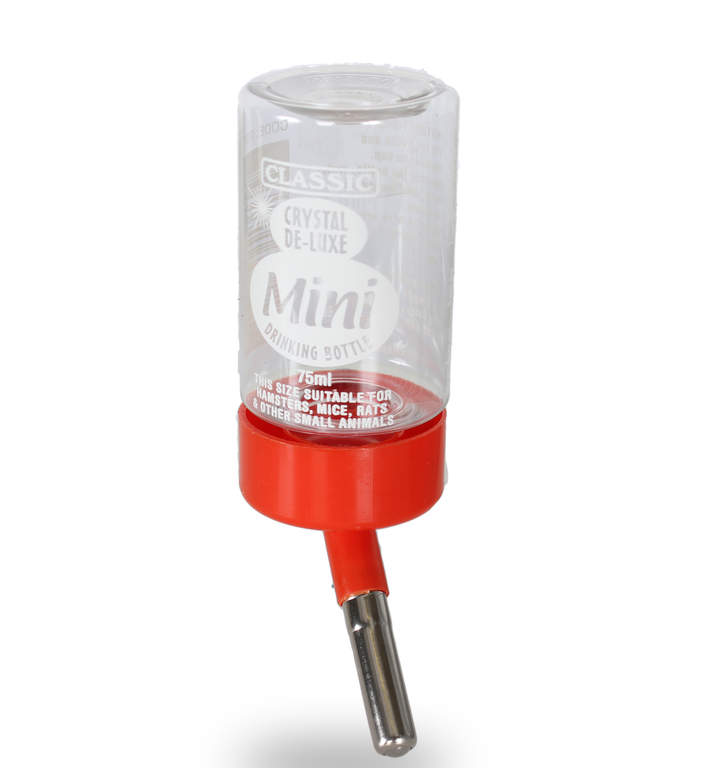

Did you all read the OP has a "CLOSED" vessel. That means no air vent. He as to fill it by compressing the air in the vessel. I submit a pressure sensor can be calibrated to indicate how much liquid is in the vessel.

But, closed doesn't necessarily mean pressurized. It could gravity fed, like this:

Right! Then he could measure the vacuum!
