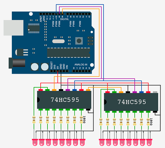

It would be something like this. But instead of controlling LEDs, if is possible to control servos, and how to program arduino to control each servo independently. Not only I will use all outputs for servos, also I will use for sensors too.
Some of what you are trying to do is doable with a 4051, others not.
You have to understand that a 4051 is a multiplexer, meaning that at any given point, only one input is connected to the output.
Because of that, a device that requires a continuous signal (a servo) would not work. A device that does not require a continuous signal (led as a visual device) would work.
Do not use a 4051 to drive an output. While there is a tutorial on this it is a stupid thing to do because you need to multiplex for not advantage at all.
You can not drive servo's with a 595 unless you use a software PWM technique which takes a lot of processor time.
So, it is not possible by any multiplexer to control many servos with Arduino?
Yep you got it. Multiplexers and outputs do not go together.
You need shift registers or a chip like the TLC5940 to generate PWM.
Anything is possible. But in your design, it is not possible.
