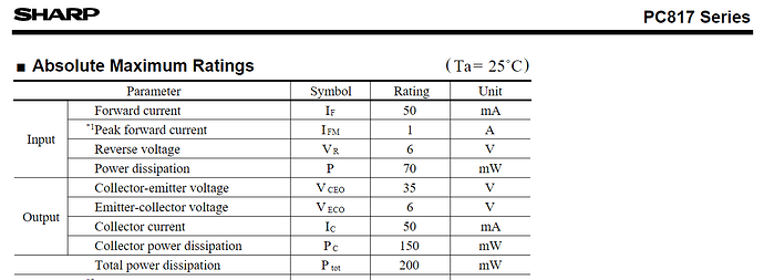

The datasheet of the optcoupler PC817 says
maximum collector current 50 mA.
If you set a current of 20 mA to keep some distance to the maximum-rating
the resistor could be reduced to
5V / 0.020 A = 250 Ohm.
20mA is even save for the IO-pin if you would accidently configure as output-pin
Power-dissipation in the resistor
P = 5V * 0.020 A = 0.100 Watts safe even for small resistors (usually minimum 125 mW most of them 250 mW)

Sir, As you told Collector Current chosen is 20mA , so R = 5V/0.20 A = 250 ohm.
Please correct me, if I am not wrong ...........From Datasheet:
When "Collector Current" is 20mA , "Collector Emitter" Voltage will be 2V.
So R = { (5 - 2 ) / 20mA } = 150 ohm
Similarly (Input side of optocoupler)
When "Forward Current" is 20mA
"Forward Voltage" = 1.2 V
R = (5 - 1.2 ) / 20mA = 190 ohm
which datasheet which diagram says these numbers?
If you supply the IR-diode with a current = 20 mA
The collector-Emitter-voltage or will be approx. 0,2V on full saturation for a current of 1 mA
The voltage-drop for 20 mA will be higher but I estimate not above 0,5V
Above 6 mA of LED-current the saturation-voltage drops down.
This means the real current will be
(5V - 0,5V) / 250 Ohms = 18 mA
Powerdissipation in the phototransistor
0.5V * 0,018A = 9 mW
In the situation of driving the LED with nominal current of 15 to 20 mA.
If your LED-current is too low
you get a big voltage-drop on the phototransistor and this can exceed the maximum of power-dissipation inside the phototransistor.
You should use a digitalmultimeter to measure the real numbers in prelimary tests.
That is what I always do with such components.
Adjusting the current limiting resistor on the LED-side to get a current in the range of 10 to 15 mA supplying the proximitity-sensor with that voltage that you are using in the real application.
then measuring voltage-drop across collector-emitter with reducing the pullup-resistor in steps or using a fixed resistor of 250 Ohms and in series a potentiometer.
best regards Stefan
