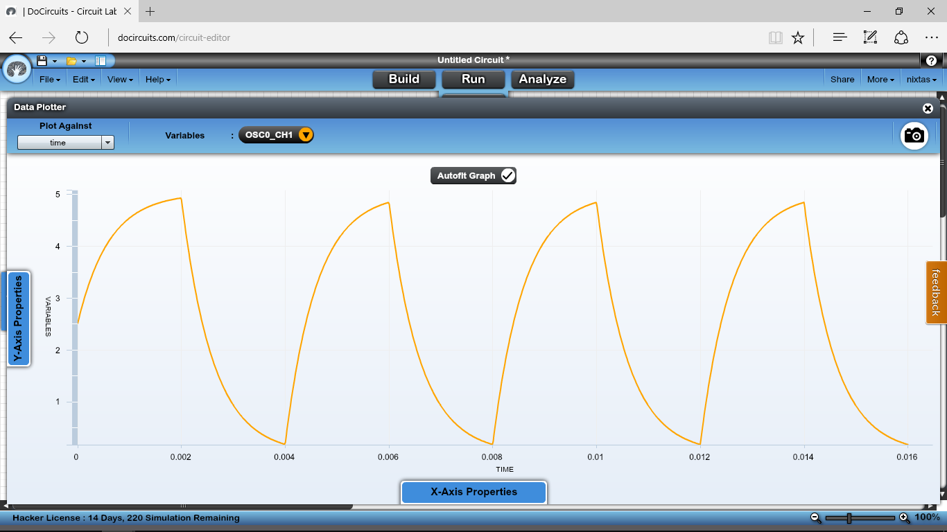

Hello,i am trying to connect a Fotek pl-05N proximity sensor to an Arduino uno interrupt pin.This sensors can be power supplied from 10-30 volt DC.I supply them from a battery that is connected to a charger so the voltage is about 14volt.The problem is that when the sensor is inactive I get 14 volts at the sensor signal output.When the sensor is triggered it drops down to 0volts.I made a voltage divider with a capacitor and a zener diode and the voltage dropped to 5volts when inactive and 0v when active.I use the capacitor to filter the signal because sometimes it get noise and gives me false triggers on rising.the max frequency I want is 250Hz.I measured the sensor output and I got 10k resistor.The problem is that the sensor seems to have very low current output and can't trigger my Arduino input.I think of using an Arduino external pullup resistor.Can anyone help me.I have attached a schematic of circuit and the output waveform on an emulator
I would try a simple voltage divider: 10K from +14V to the NPN output and 4.7K from the NPN output to ground.
The junction of the 10K and 4.7 K should vary between 4.5 and 0V, which will be safe for the Arduino and sensed as 1 or 0 by a digital input.

After testing I figured that the Black Cable(output) gives you the voltage you power supply the sensor.In my case the 12Volts as I installed a voltage regulator today when is not triggered and ground when it triggers.Also the internal resistance of the sensor as I measure it from output and ground is 10KOhm.I want to give more details about my project because I am really at the end of it(I believe)and I have problem with noise at my input.I have two sensors installed on my motorcycle one on front wheel and one on the rear and I am measuring the wheel speeds.I have tested my project on a breadboard and it works fine but when i install it on my motorcycle I get false input triggers.i use interrupts and the sensors cables especially the front one passes under my fuel tank were are the spark plugs.when the bike is turned on and I get a reading from the wheel sometimes it gives false triggers.i used a oscilloscope at the input of Arduino and I got something like the picture attached.i also attach the circuit I use.The power supply of my sensors and my Arduino is supplied from my motorcycle battery after a voltage regulator.
