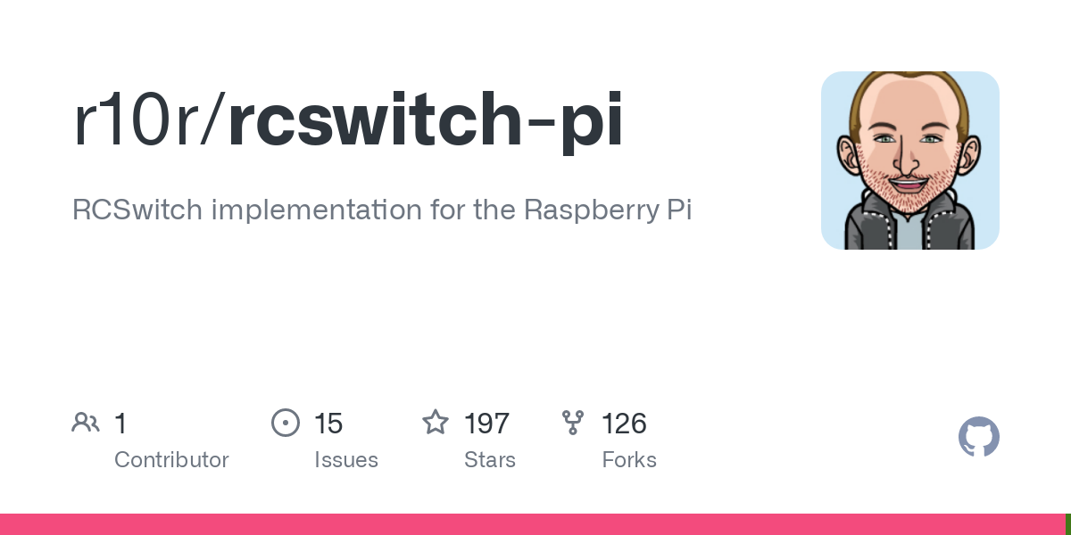

Another possibility is something like this.
Many of these RC light sockets use a SC2272 or clone decoder, of which there are Arduino libraries to generate
the data format needed.
All you then need is a cheap 433 Mhz ASK Transmitter.
Sparkfun have a speech recognition module
And this library works well with most 433 operated switches, I've managed to get it to work with at least 3 different brands including ones that have their own micro controllers (like WattsClever)
So this is totally do-able
