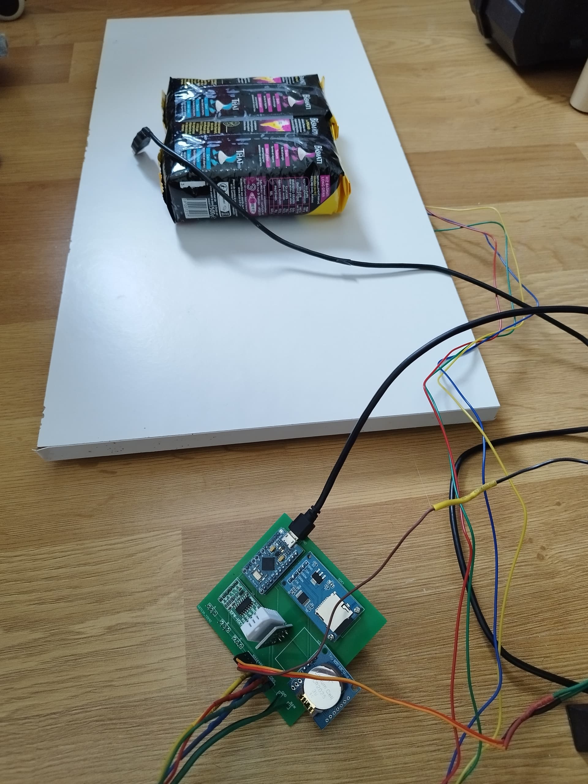

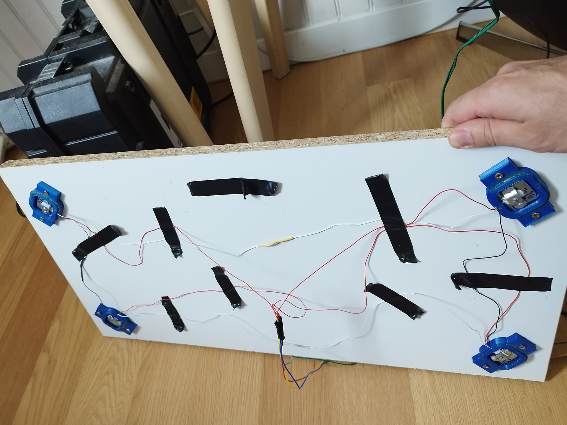

Hello everyone,
I am making a weight system for a beehive with an hx711 and four weight sensors. I wanted to know if my circuit is correct because my scale drifts in time. I have connected the DT pin of the HX711 to the D8 pin of the arduino pro micro and the SCK pin to the D7 pin of the arduino. I would like to know if my assembly between the HX711 and the arduino is correct. I connect the module with 5v correctly. I join the diagram of my wiring.
Thank you for your help.

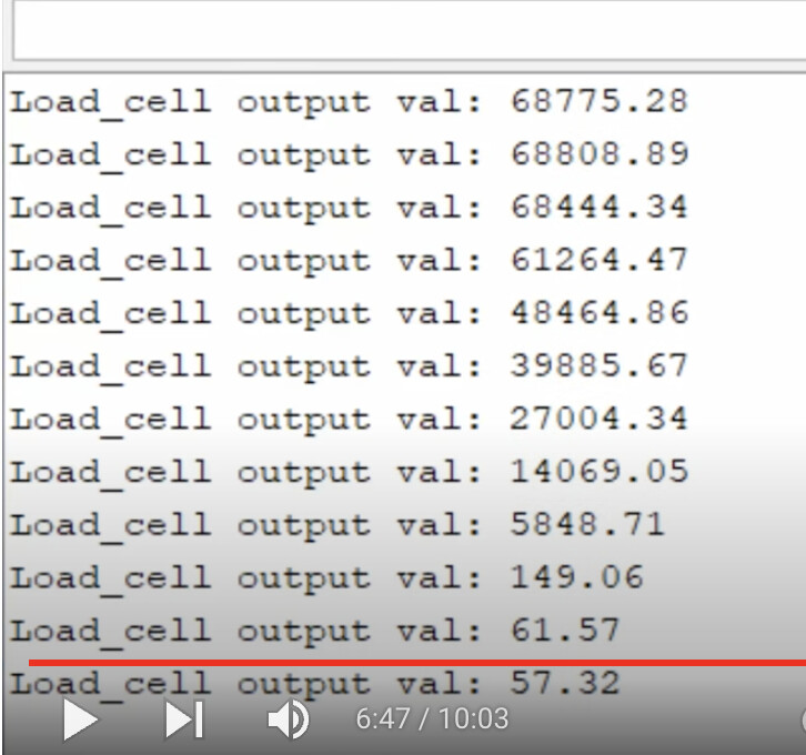

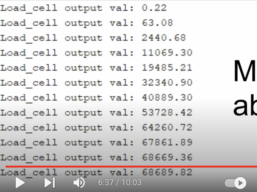

I was inspired by this video : weight sensor
At 6:20 he tests the scale and his measurement uncertainty is much lower than mine.

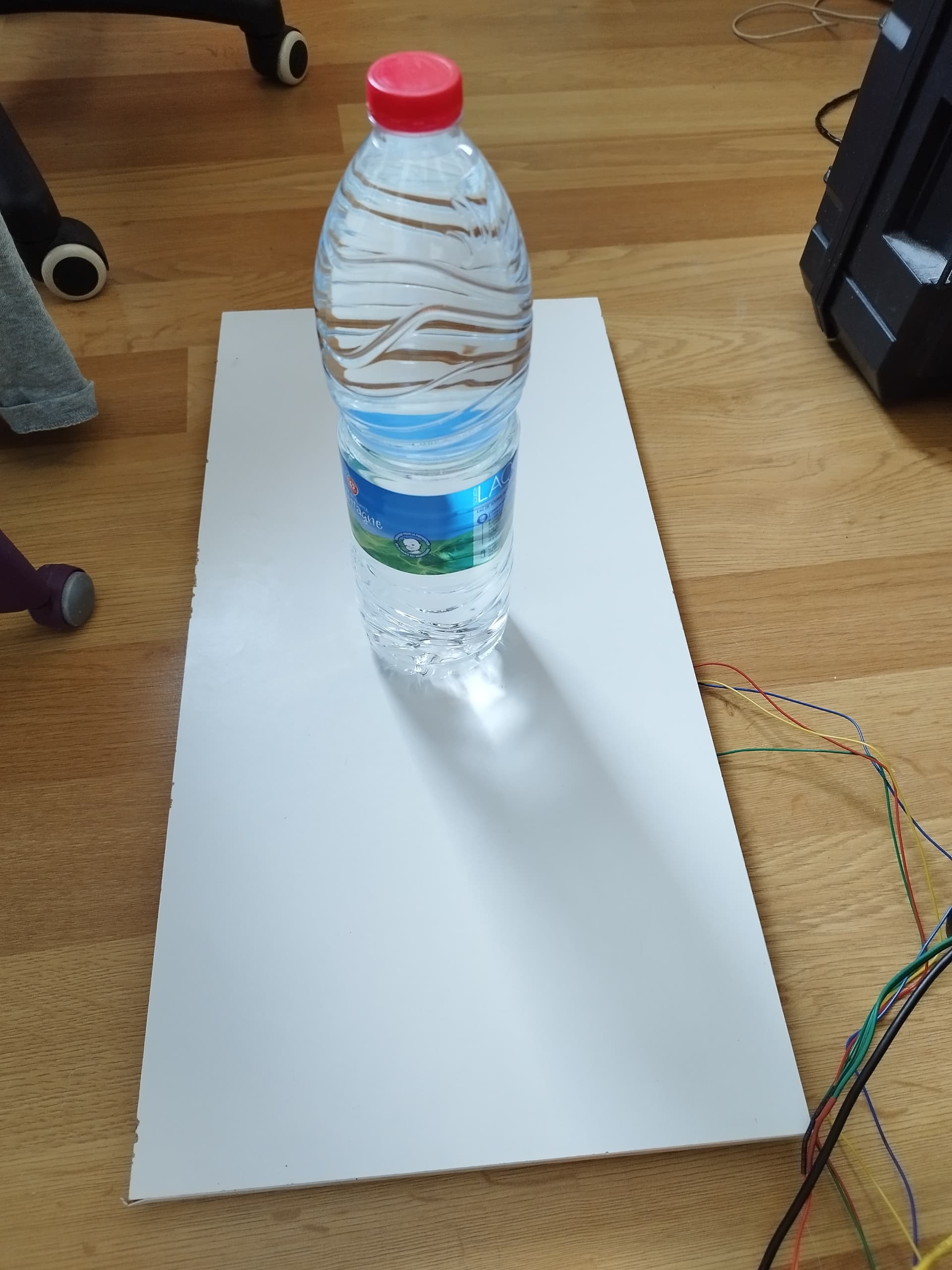

I send you an example where I'm trying to calibrate my scale with a one-kilo packet of rice.

It isn't the issue, but I'd subtract t from both sides here:
...so you are comparing intervals rather than absolute, rollover susceptible timestamps:
if (millis() - t > serialPrintInterval) {
I'd also set serialPrintInterval above zero to so your results happen at a knowable rate and you can see loaded & unloaded values on the same screen:
 const int serialPrintInterval = 1000; //increase value to slow down serial print activity
Does it drop back down to zero when you remove the bag of rice? Or double if you add a second bag?
If so, the code and circuit seem to be working.
What is the calFactor? because it doesn't look like 1 or raw output from the device.
What does your physical setup look like?
If your sensors are bottomed out/aren't properly mounted, it could be that the circuit and code are amplifying noise.
I made the changes in the code. I tried to put a bottle of 1.5kilo and after I put a second and then I remove them as you can see in the values.
I find that the scale drifts a lot compared to the tutorial video.
Startup is complete
Start calibration:
Place the load cell an a level stable surface.
Remove any load applied to the load cell.

That data looks reasonable. I think the circuit and code seems functional.
From watching the video, it looks like it should work similarly.
The video looks like there's some smoothing in the processing:
And the referenced 50kg Load Cells with HX711 and Arduino. 4x, 2x, 1x Diagrams. - Circuit Journal says:
It takes some time for the level to settle back to zero after having a little heavier weight on it. For example, if I step off the scale, it goes quickly back to about 50g. Then it takes some additional time to reach back to zero again.
The library does some internal filtering and smoothing:
The only things I can think of are differences in the smoothing parameters (sampling time? frequency?) and perhaps the board and flooring might be different (more flexible or resilient).
The video looks like it reports every 1/4 sec or so, and smooths between them.
This code looks like it would sample as fast as the board will go, and then report the smoothed data only periodically:
If the sampling is happening much faster than the reporting, then the window would flush out, and the reported readings would be more independent. If you were running your HX711 at 80Hz and the video was running at 10Hz, or if Video's code was structured to throttle the readings like:
    if (millis() > t + serialPrintInterval){
      LoadCell.update();
      float i = LoadCell.getData();
then the video's successive prints would share a lot of the smoothing window and show less variation.
Do you know for sure that your code matches the video's code?
Otherwise, maybe it's mechanical, and the way your board bends, combine with the way the bumps on the sensors interact with the resilience of the flooring might be different.

And if i tried to make the same experience, i put my bottle of 1.5kilo on the scale and after i get on the scale (my weight is about 80 kilo) i obtain these values :
`Startup + tare is complete
Start calibration:
It is assumed that the mcu was started with no load applied to the load cell.
Now, place your known mass on the loadcell,
then send the weight of this mass (i.e. 100.0) from serial monitor.
Known mass is: 1500.00
Calculated calibration value is: 9.95, use this in your project sketch
Save this value to EEPROM adress 0? y/n
Value 9.95 saved to EEPROM address: 0
End calibration
For manual edit, send 'c' from serial monitor
