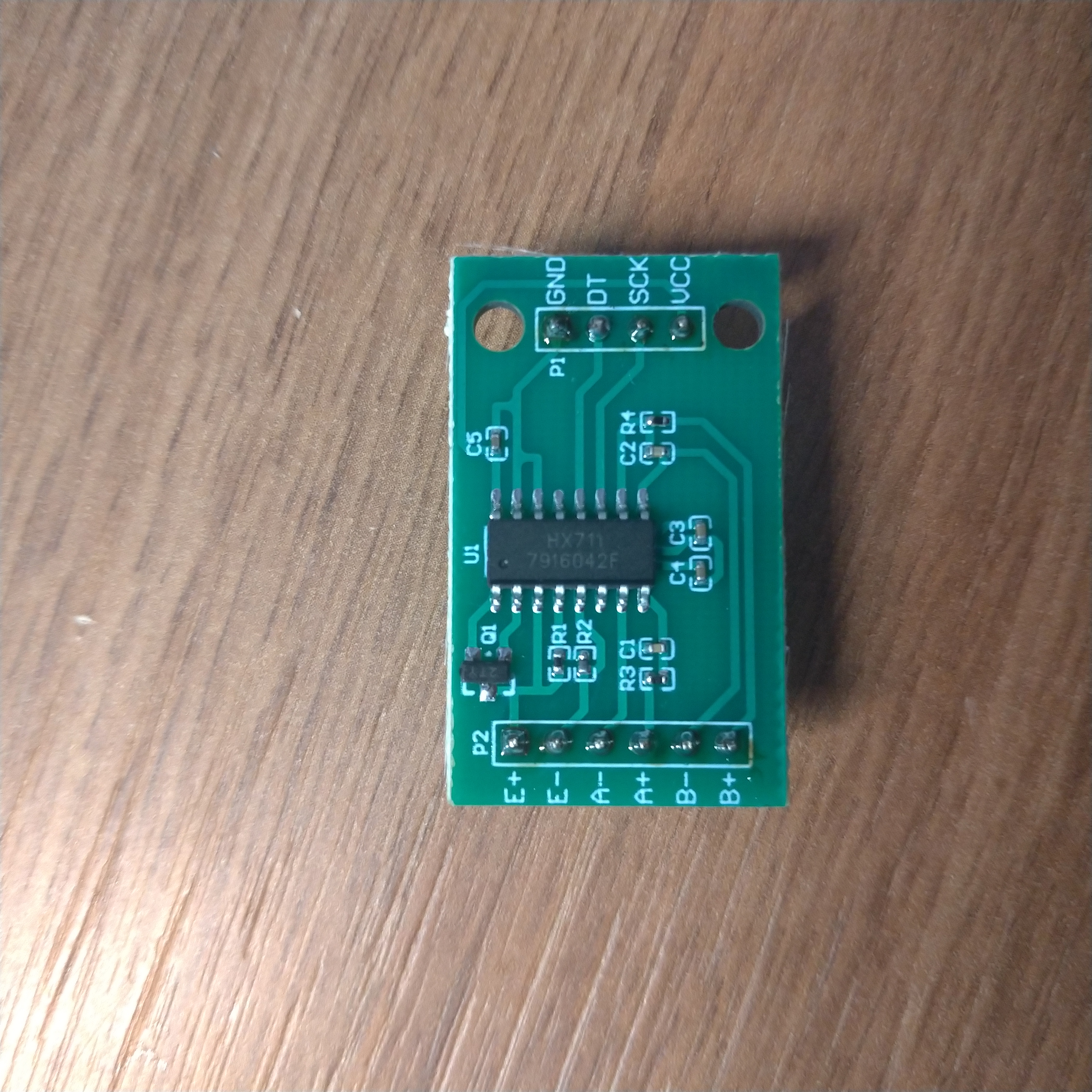

Hello, I would like to get some advice from you. Can I create "custom clock" with arduino in sketches? Maybe with delay? If not possible, how to make this chip work at 80hz? I have read some topics, but thisHX711 chip is from other manufacturer. Is there in another possibility then desoldering pin 15?
Picture of this chip below :D.

That seems the version of the board where E- is not connected to ground, and the rate pin is not accessible.
To convert this board, you must cut the trace to pin15 (currently grounded), and connect it to VCC.
Pin15 is the one next to the top/right pin.
Google "HX711 datasheet" for more info.
Maybe you should buy a HX711 board where it's easier to modify this.
Note that, in general, performance goes down if speed goes up.
