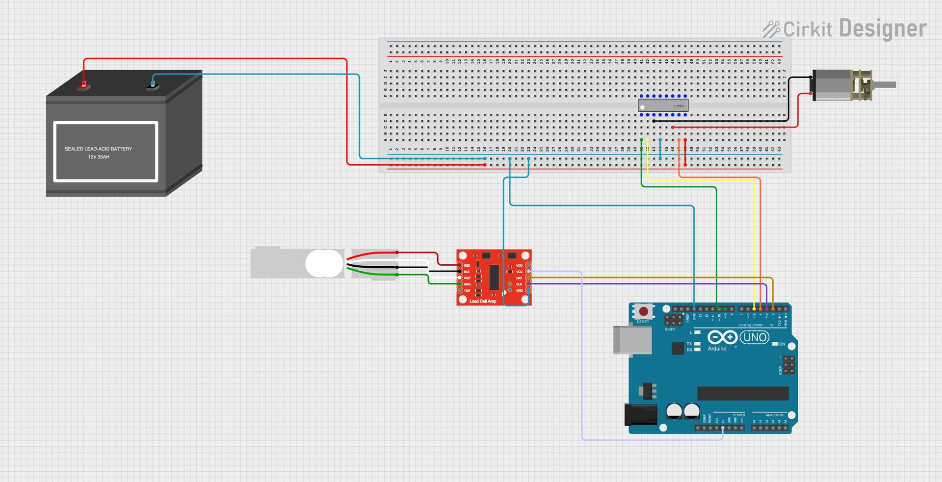

HX711/DC motor Breadboard Layout
Hello Arduino Community,
We are currently facing an issue with our setup using an Omega strain gauge compression load cell with an excitation voltage of 10V, connected to an HX711 amplifier, interfaced with an Arduino. Despite following the standard procedures, the voltage readings from the load cell are constant and do not change when the load cell is touched or loaded. We have ensured that the load cell and amplifier are undamaged by swapping components.

Despite this code, we are seeing constant voltage readings that do not change with applied force. We are wondering if there might be an issue with our wiring or circuit setup. We would appreciate any insights or guidance on verifying our circuit placement or debugging the code. Thank you!

Your Fritzing shows a HX711 board from Sparkfun, with the VDD pin not powered.
Both VCC and VDD if this board must be connected.
So which HX711 board did you use (link).
If you did use a cheap board, then check continuity between E- and GND.
There are boards out there with a manufacturing fault, where that link is missing.
Leo..
