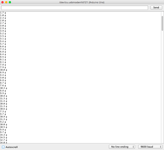

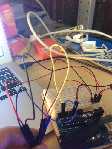

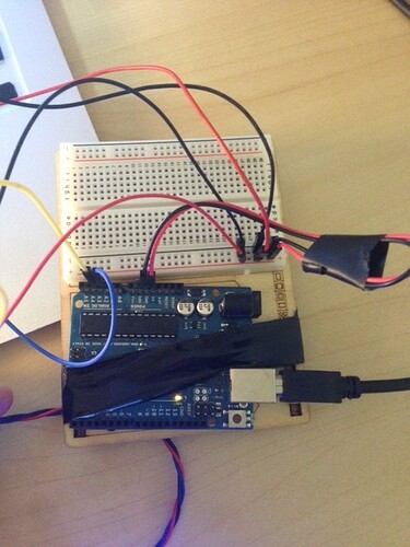

Hello, I posted awhile back about using the HX711 DFRobot weighing module. It worked great back then and I had no issues with it. I am using it again after 8 months and it is no longer working and I am unsure why. When I hook everything up the serial monitor shows values that just keep increasing (attached pic) and does not respond when I press down on the ends of the load cell. Below is a picture of my wiring and all my parts. I’ve tried changing the weighing module, changing the load cell, changing the arduino and none of those worked.
I am using aguegu’s code and library (ardulibs/hx711 at 3cdb78f3727d9682f7fd22156604fc1e4edd75d1 · aguegu/ardulibs · GitHub also found on this wiki Weight_Sensor_Module_V1-DFRobot) and have used it in the past as well as bogde (GitHub - bogde/HX711: An Arduino library to interface the Avia Semiconductor HX711 24-Bit Analog-to-Digital Converter (ADC) for Weight Scales.) with no problems. It might be a simple problem I’m not sure, if anyone has experience with this problem or experience with the DFRobot weighing module I would love the help!
