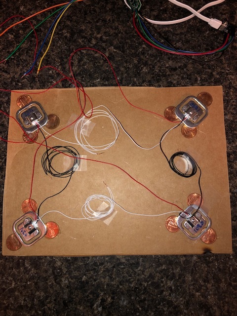

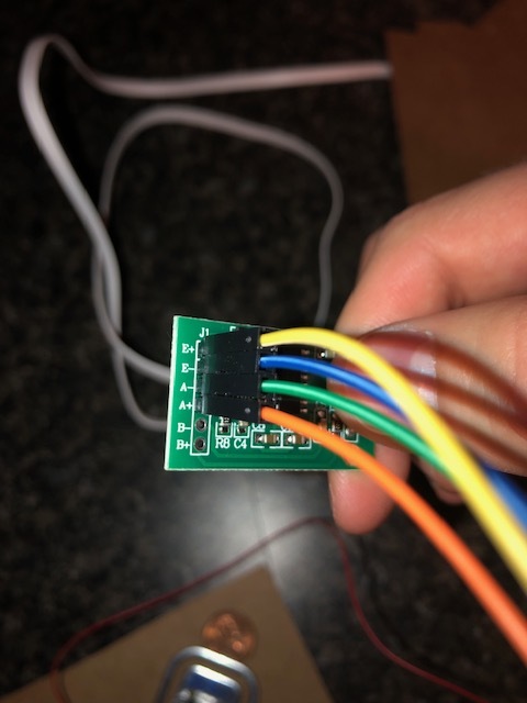

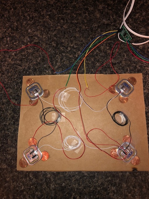

I have been having some issues getting up and running with my HX711 and Adafruit Trinket M0.
I am using the GitHub - bogde/HX711: An Arduino library to interface the Avia Semiconductor HX711 24-Bit Analog-to-Digital Converter (ADC) for Weight Scales. library, 4 50KG load cells and a HX711. I have attached a picture of my wiring and the serial output.
This is the second hx711 board I have used and still seem to get these odd values.
Any help is appreciated.
Thank you.

Depending on the used breakout board (you failed to provide a link to it's schematics) you power the board wrongly. As the Trinket M0 works on 3V3 you should power the HX711 with the same voltage to have a compatible voltage on the communication interface. Check the used pins on the Trinket M0 (0 and 1) if they still work (you might have fried them already) before connecting the HX711 again.

I figured out what was wrong. I had the wires coming from the load cells paired incorrectly. Luckily the Trinket pins were not fried.
Thank you for your help!
