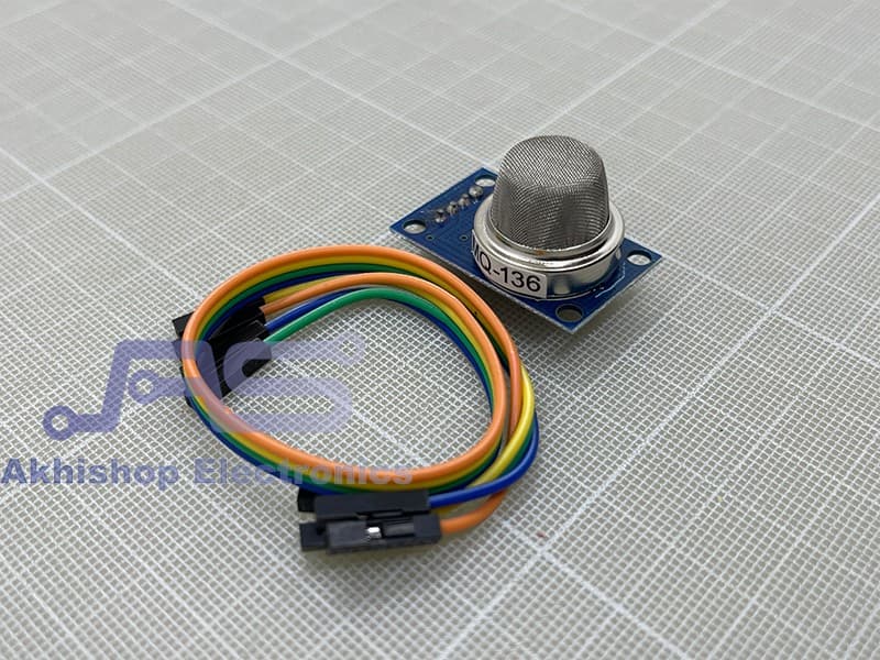

Hi i am new here, And i am currently working on a project for a biogas monitoring system. I am currently working on the sensor as i am speaking. And i would like to ask about how do i make sure that the sensor i am using is calibrated properly for its intended use. And for more information this is a sensor that i bought online with the module included. This is the source code i am working on:

I am just aking opinions on should i go to company that has a calibration service to help me on making sure that the sensors are producing the right outputs or should i just stick to the datasheet and experiment more?

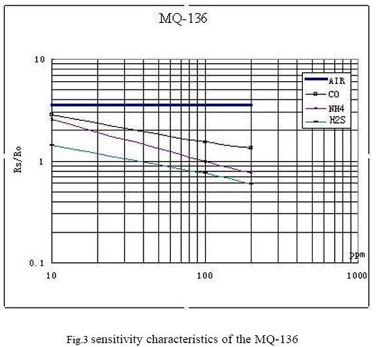

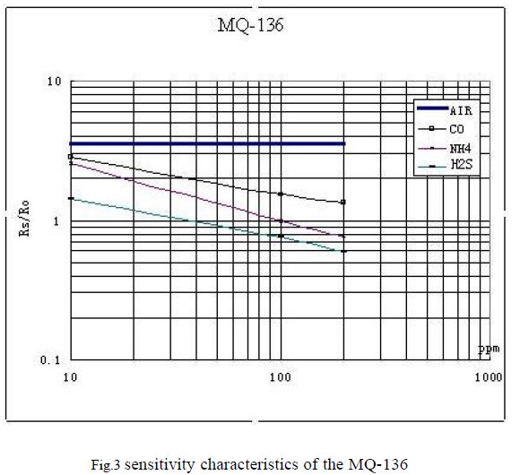

This is the sensor i am using for refrence, and also the datasheet i am using is this one: MQ-136 Datasheet(PDF) - Hanwei Electronics Group Corporation
To calibrate a gas sensor requires exposing it to mixtures with known concentrations of the gas, measuring the output and calculating an offset and scale factor.
Unfortunately, the MQ sensors all respond to more than one gas. The MQ-136 data sheet shows (see below) that it responds to ammonia just as well as H2S, so if both are present, it is impossible to distinguish them.
If you are want to measure a particular gas, you need an industrial sensor specific to that gas.
