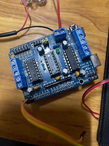

I am using L293D motor shield and Arduino Uno to drive 4 motor but the Voltage in the M1 and M2 is low and M3 and M4 is high. So I can’t drive the car in a straight path. I tried using another L293D and the problem is still same.So could you please help me solve this problem?
The motors' windings are not the same inside (or there is hair wrapped about the axle of the slow motor). Adjust the PWM to the "strong" side until motors drive equally.
Thank you for the reply. I am the new user so could you please tell me, How can I adjust it? Should I adjust it through programming?
Yes. Connected an Arduino PWM pin to the ENABLE pin (ENA and a second PWM pin to ENB).  Use analogWrite(PWMpinA, value); and adjust value from 0 to 255 (try 50 to 200... because of power loss, 50 might be the lowest the motor needs to move, and "200" to not send max power to any DC motor for extended periods).

I attached the L293D over the Arduino Uno and I connect the motor to M1, M2, M3 and M4. I give the external power supply of 12V through the ext pwr of L293D.

12volt with those motors might be too much for an L293D. Different drop-out voltages (loss) between chips under heavy motor load could vary motor speed.

could you please how much volt is suitable? I tried with 5 volt and still same .
Your motors are not connected to your L293 driver board.
What is connected to Pin0 and Pin1?  Disconnect if not used.

A 5volt motor supply is too low.
If the chips don't get hot, then keep using 12volt.
Two 18650 batteries in series could be the sweet spot.
