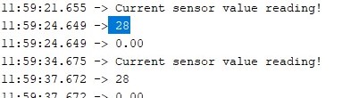

I can't convert string to int
I have a problem converting a string into an integer or a float. It shows me that I find 0.00.
You can help me
I am attaching an image with the code and the serial monitor below!
Thank you very much!
is how I do it x_eData.RM0 = String(px_message.payload).toFloat(); and x_eData.RM1 = String(px_message.payload).toInt();

This is my code.  The source of sting is a value of a sensor
What does the serial print show?

this is what serial print show
Yes, the sensor give value from 10 sec to 10 sec
28 looks like an int.
it a string. That i want to use toInt syntax.
And try the math like this
float real_value = (float)value*0.75;
ok. I will try
It is an integer after this point.
it shoud be, but the result of :
is 0.00.
i tried what you suggest:
but same result, 0.00.

yes, it's 7.500000.
What i can do in this case?

     Serial.println(value);  // See if the .toInt() is returning zero.
     float real_value = value*0.75;
it will be 0
run this code-version which does output everything after each processing-step
