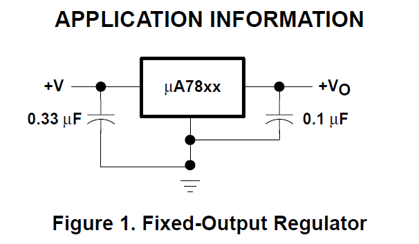

What value capacitors do you have around the 7805?
I see only one when the datasheet recommends;

thanks for the reply, i will draw a better schematic and upload it. About the capacitor i was using two 104 ceramic capacitor, they should be 0.1 µF, do you think they could be a problem? I see from your picture that i should have used a 0.33 µF for the input. About the power supply i would say it isn't the most reliable one, my 24v power supply is still being shipped so i figured I could have gotten away with two 12v power suplly connected in series, i tested the output with the multimeter and i got 24volt, the arduino was connected after the voltage regulator so i felt safe
