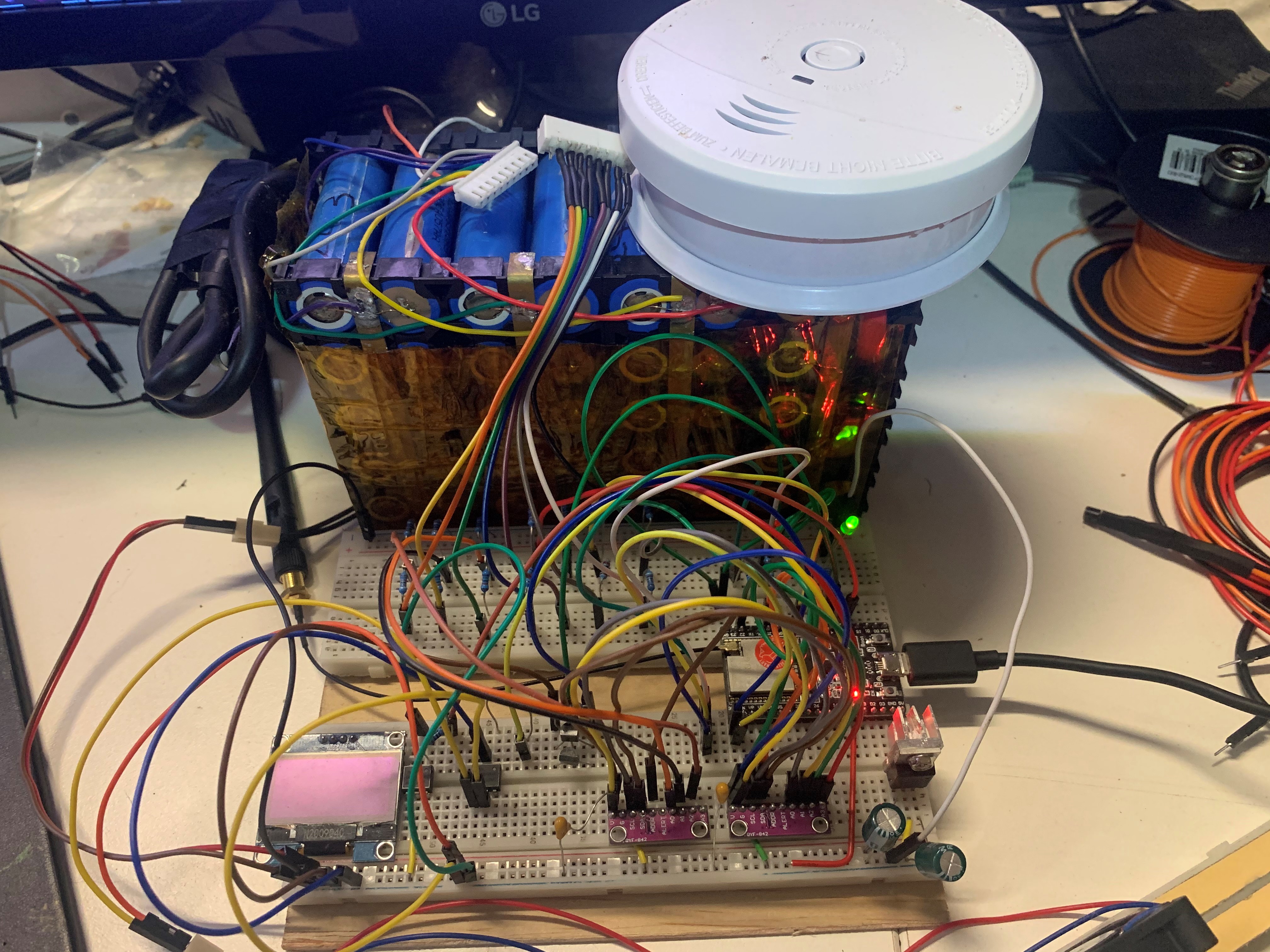

Can you post some clear pictures of your project please, so we can see your component layout?
Thanks.. Tom.. :slight_smile:

unfortunately yes, but do i get bonus points for using 2 bread boards (see pictures)?

sure can, see below:

By the way, I love the smoke detector in your picture. Hasn't the Boeing Dreamliner got a similar battery installation?
oh man I had no idea that you could get configured ICs that do that stuff, freaking cool. Will definitely look into that, looks like people have some guides on how they have used it and even some published PCB designs. This would be a whole new learning curve :confused:
Safety first, hopefully that plane didnt crash :confused:

connected reliably and before any other connections, and also rely on Vcc being always active.
For instance Fig 2 on this page shows the technique - although you already have the resistors,
only the dual schottky is needed. A/D Protection Circuits, Protect Analog-to-digital Converter from Excessive or Negative Input Voltages
MarkT:
Adding schottky diode protection to each analog input of the ADS1115 would be wise.
I agree 100%. I've used ADS1115s for years and routinely protect the inputs with Shottky diodes to both Vcc and ground. Some inputs are connected to long cable runs and there is plenty of spike-inducing lightning in my area, but I haven't lost an ADC yet despite years of continuous operation.
S.
